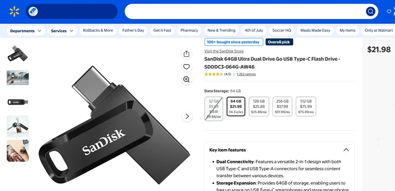

Picked this up from Walmart:
64 GB San Disk Flash Drive
Dual Port USB-C & USB-A
$22 (units were in stock):
The trick was using the correct Windows format method so the car would recognize it.
Windows default option is exFAT, Dodge's Uconnect system does not like exFAT.
I had previously posted about this situation. Formatted it under NTFS, all ok.

Fat32 should work fine as well for the uConnect. For those reading this with a Daytona with DXR, that requires exFAT.

Thanks! I love the dual port ones.
