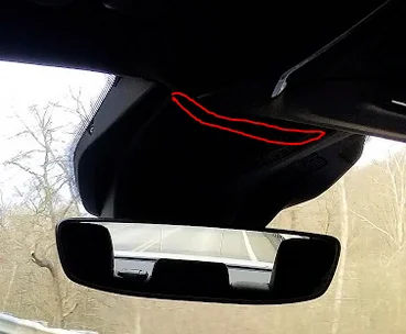

Hey! I actually did this for a dash cam / radar detector setup in my car. Check out Dongar (funny name, good product). They have an adapter that plugs into your mirror and doesn't need any wire taps, just unplug the connector that is up there, and plug in their splitter. Basically it adds a power only USB C port to your rear-view mirror.
Make sure it will work with your dash cam's power requirements. Some need 12V and some have other needs.
They didn't offer one for the 2026 model when I bought it but they did have them for the 2024, which is identical to our car.
To install the adapter, or whatever method you decide to go with: pull down carefully on the top lip of this piece of plastic in the center, a big part of it comes off pretty easily. I had plenty of room to hide the adapter and wires in there too. That compartment does get quite hot in the sun but so far no issues with the adapter. It seems to be able to handle the heat.
