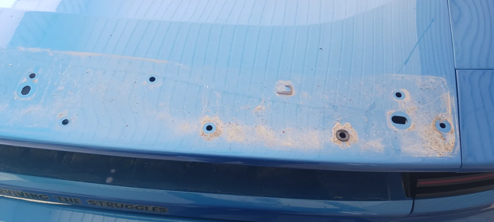

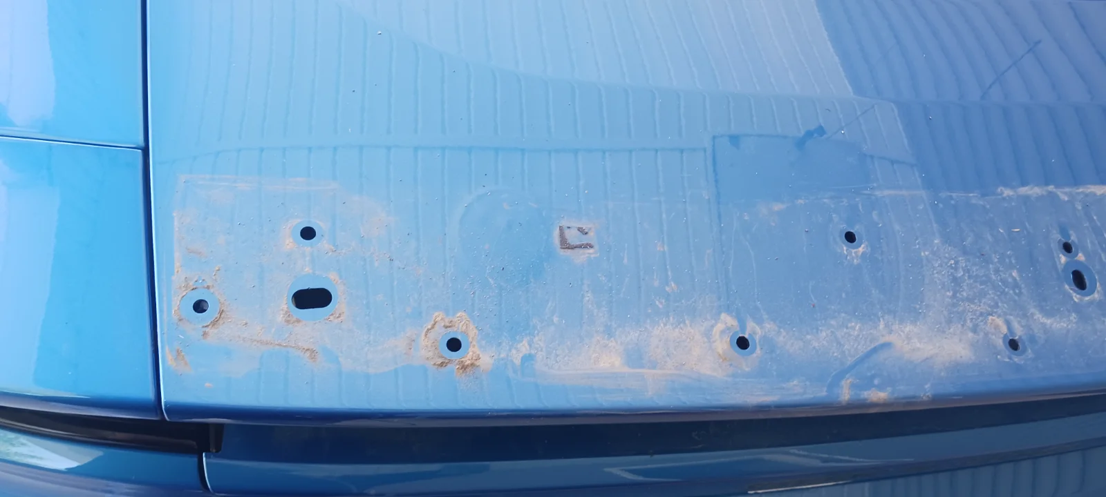

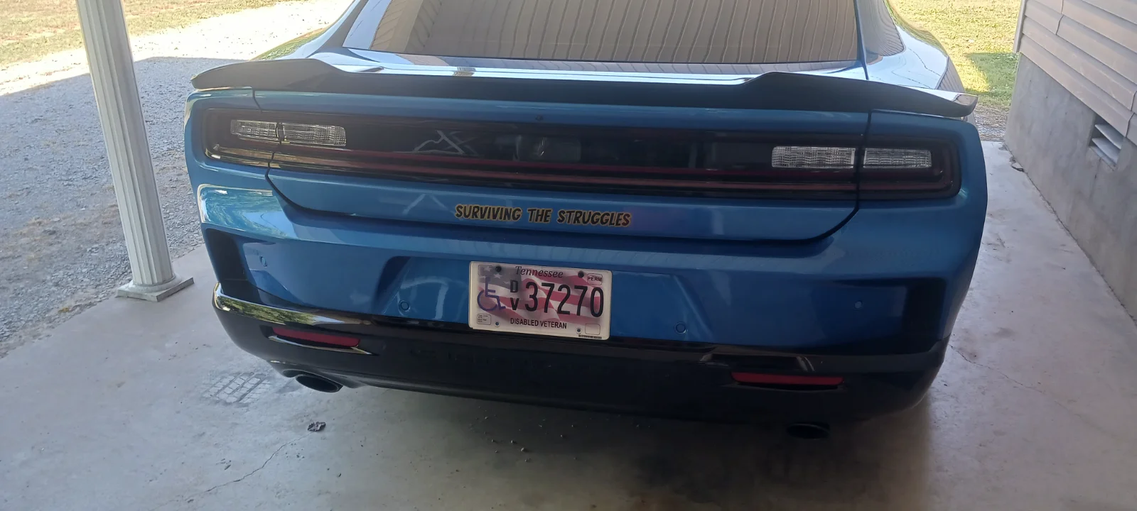

I swapped spoiler to AeroFlow Dynamics
All those damn holes! I assume the AeroFlow doesn't use all of them?
No holes, the bottom is solid with a strip of double sided tape at the ends and 3 additional straps the length but I also added 3 additional strips of Gorilla double stick tape
After putting it on temporarily with a couple pieces of tape, I'd mark it through those holes from underneath. Then I'd install a couple of inserts and bolt that sucker down as well.
I know a LOT of stuff is done with only adhesive tapes, but I'd want actual fasteners as well. Keep IT stuck down tight, and keep other sticky fingers from walking away with it.
I had seriously thought about that but there is so much other stuff(camera housing,wiring and other plastic trim)it's nearly impossible to do that. You'll only really be able to get to the 2 end(1 per side)bolts
Once you run it through the wash let us know if it still holds water like the OEM. Its so annoying that it does that. I feel like they didn't wash the test vehicles. lol
I totally agree with you. I seriously doubt very much dirt/water will get under it since it's pretty much sealed all the way around. I never run it through a car wash,hand wash only
