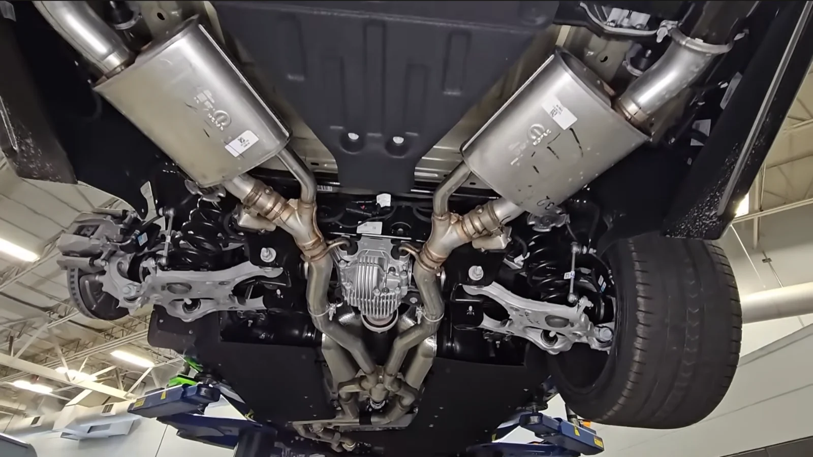

Do we know if there are valves under the rear seat, outside, like the SRT's? In my garage, it is loud as heck until they open, then it quiets down a lot. I'll go look at a couple of videos to see if they are there.
You can see the AEV on each resonator pipe in this shot. I'm sure someone will have the bypass made soon just like with the Hellcats.

The valves look very similar to the outgoing charger. I wouldn't be surprised if they are the same and the deletes for the old models may work, but I have not checked them up close so don't trust me on that.
Not something in interested in though. I share a parking lot with my neighbors so the ability to keep the exhaust a little quieter is ideal. Might get an aftermarket manual control valved exhaust in a few years though. It's just so hard to commit to an aftermarket exhaust unless I can hear it in person before I go slicing my car up and dropping all that money.
