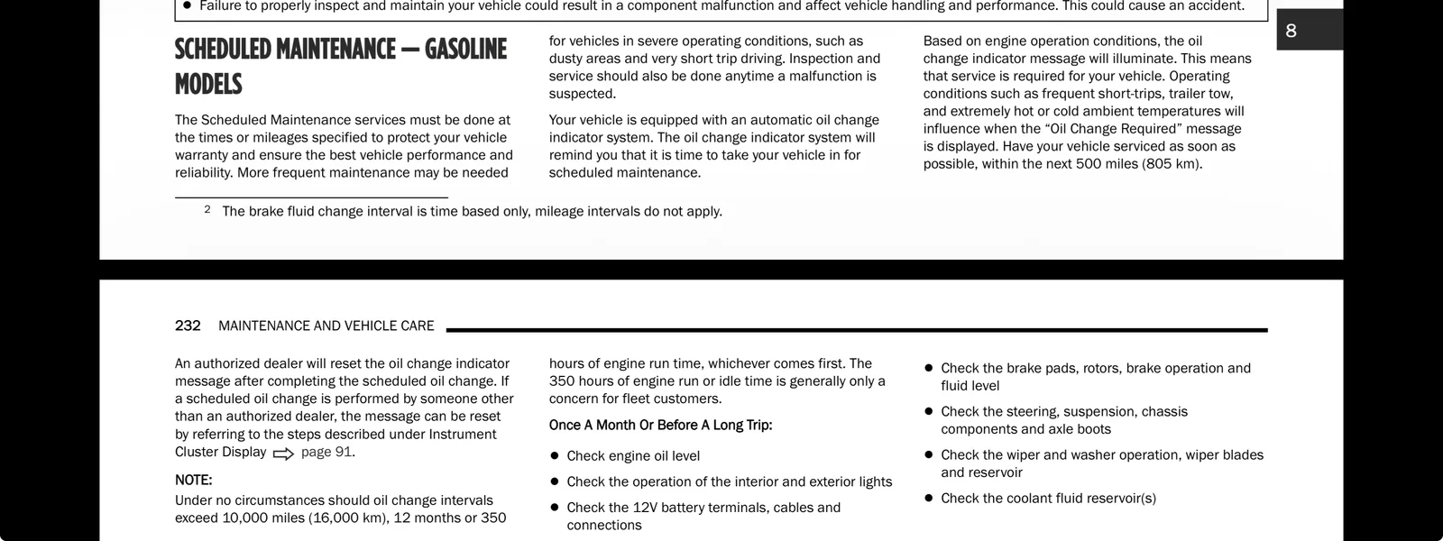

What’s interesting is the manual doesn’t even have a recommended oil change schedule. I’ve never seen that before. It just says to not exceed 10,000 miles, 12 months time, or 350 hours of engine runtime.
There is no break in oil now days. Most that are changing oil at around 1000 or 1500 miles do it just in case you have some metal shavings in the oil. Most likely the reason they did not put a mileage recommendation in the book as you now have an oil life notification as to needing to change oil. Later RJD
