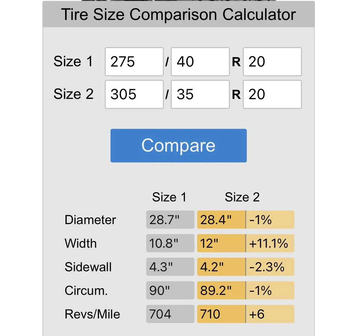

Does anyone know if there are any alignment or suspension changes that are required by installing the factory 305 tire/wheel combo on a car with factory original 275’s?
If you get the right wheels with the correct offset like the factory ones, nothing at all.

I understand that, but if they are the same diameter, it's all the same.

Not much difference at all, I would think if you can slide your hand around the inside of the tire without hitting upper control arm, they would fit. I just looked at mine, and seeing the diameter is a little smaller on the 305, and the 305 is only 1.2” total wider, .6” in both directions, I can fit my hand around the back of the front tire.

At least for my 16 Road and track Swapping the 275/40/20x9.5 in place of the original 245/45/20x8 fit like a glove since I used OEM hellcat wheels. Since both tires are the same overall diameter/ revolution per mile the speedometer is the same. Even different brands of the same size will have different measurements, like shoes

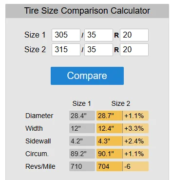

Also the Widebody Scat/Hellcat guys are running 315 tires on the stock 11" wheels with no issues other than a bit of road sand blasting since they stick out a touch. Up to 325 would still officially fit the 20X11 but the factory bumped that to 11.5" with probably a bit more negative offset to tuck under the fender. The catch here is the EV is likely tolerant of a different diameter rear tire. My Marauder has about 2" taller rear tires calibrated into the Traction control and ABS but no AWD differential to worry about

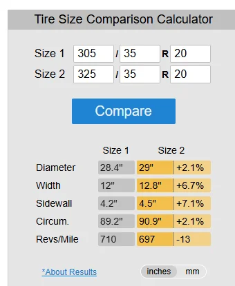

If you go for 4 equal tires these should fit

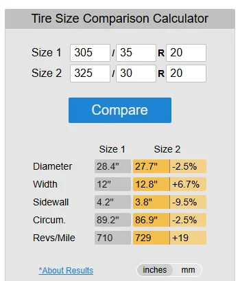

The 325/30/20 has a few more options, Michelin Cup 2 available Slightly shorter may help avoid rubbing, but likely needs a custom wheel offset and Front?? Someone else can experiment, those are $800 tires
