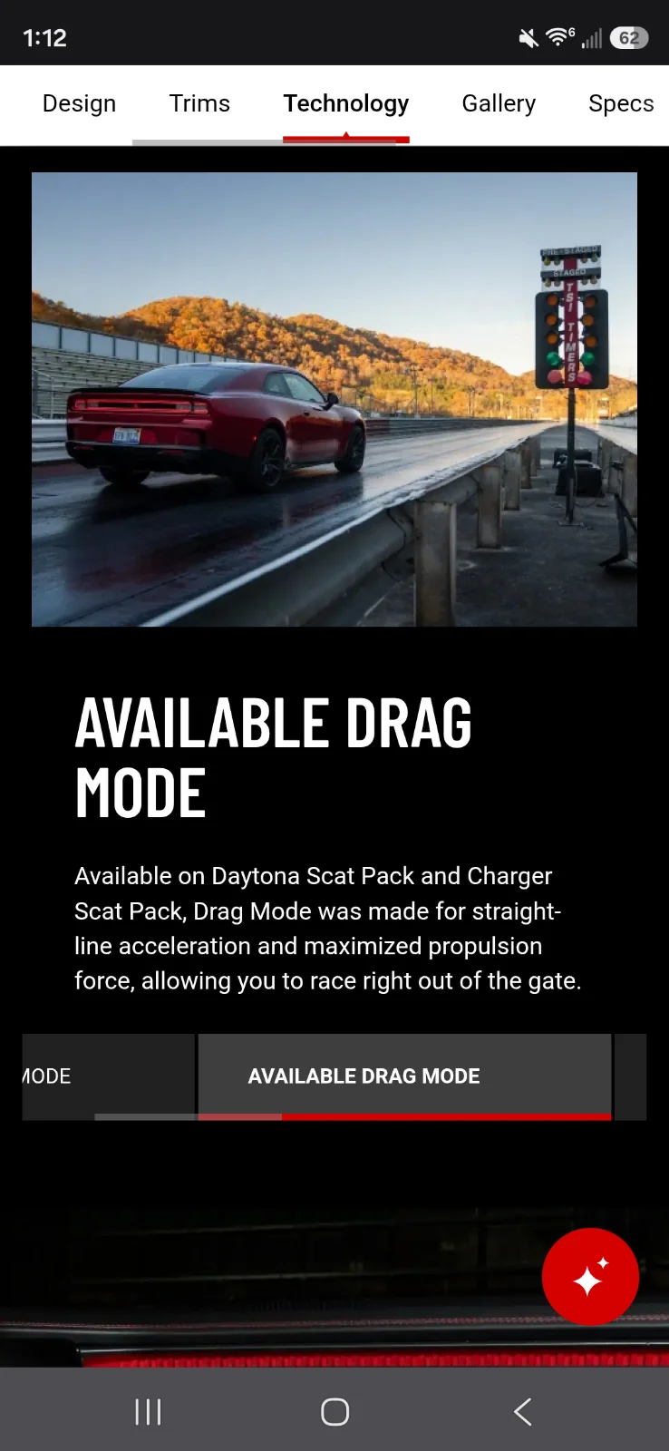

In the same situation , But Dodge may have a class action on their hands , The official site clearly states it has Drag mode
It does now. When it first was posted it did not. It wasn't until it hit lots and people got them they put that on there. I also have heard you can get them back by getting another update. /shrug

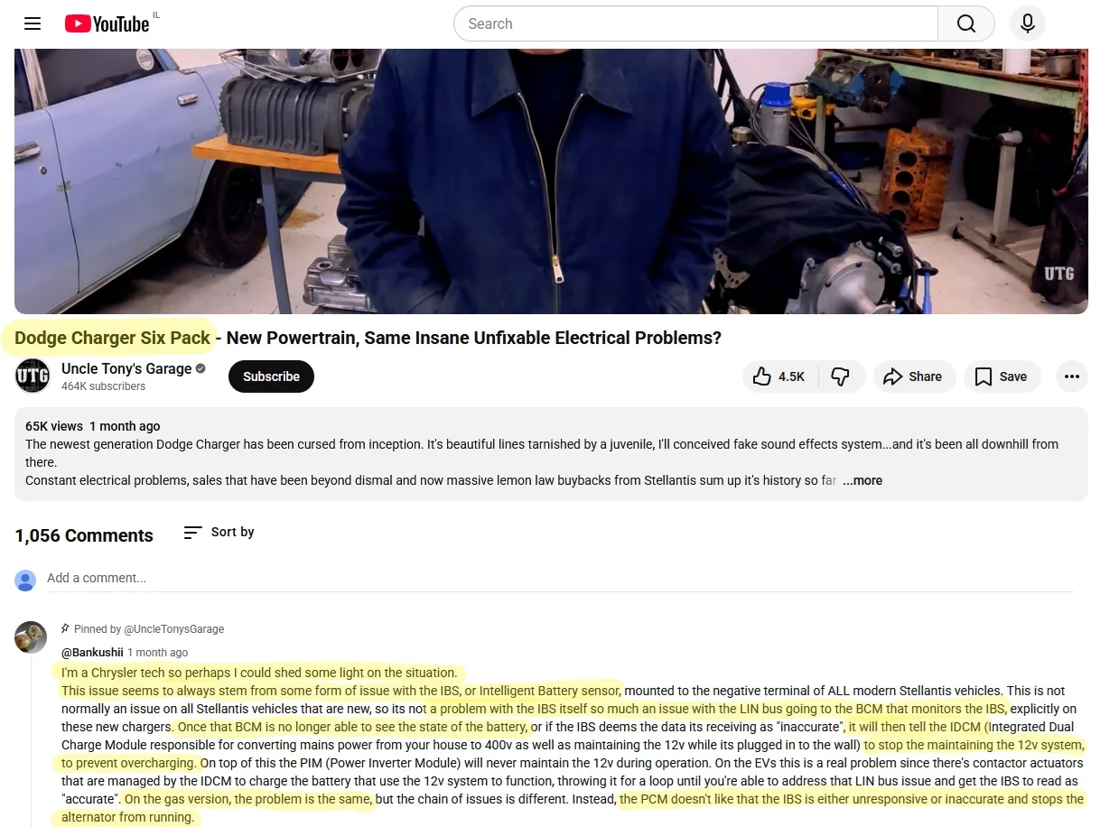

Here's a screen shot of a reply (allegedly from a Chrysler Tech) who explains what he thinks is the issue I recently encountered with dead/bricked Six Packs.
Once again (for the record), I went to two different dealers in my area with the intent of driving home in a new 2026 Six Pack ICE Charger.
All 3 of the vehicles I chose would not start, nor did any of the dealers show an interest in attempting to start them or remedy the issue.
I am currently a Dodge owner, and drive a Durango SRT 392.
If any of that is true,
1 - That sensor (on basically all new cars, any make) and its programming behind it, could explain a lot of these issues.
2 - If #1 IS true, then it is horrible in my opinion, since they have been testing this platform for 2 years now.
