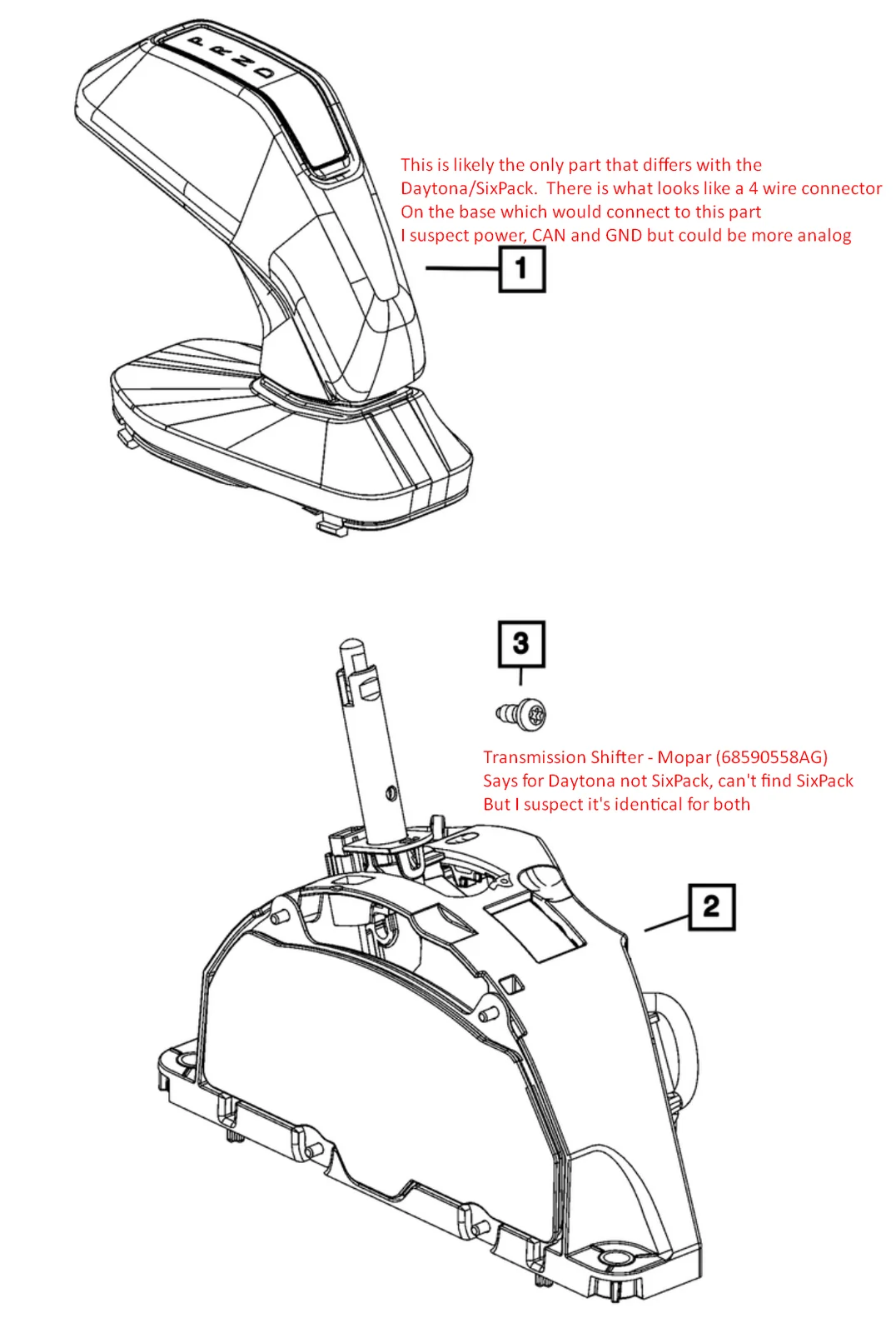

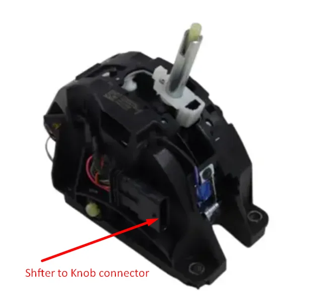

Looks like removal would be prying up the boot and then finding this little screw that dowels the shifter handle/knob onto the base shift unit. Probably press fit and the screw and a single 4 pin looking wiring connector.

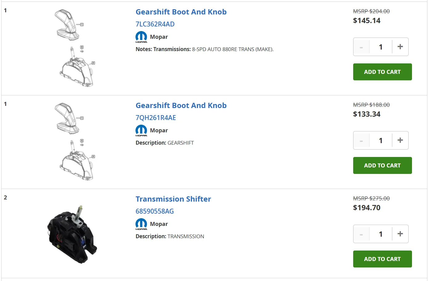

PS: Base is the same for both cars:
