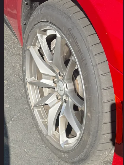

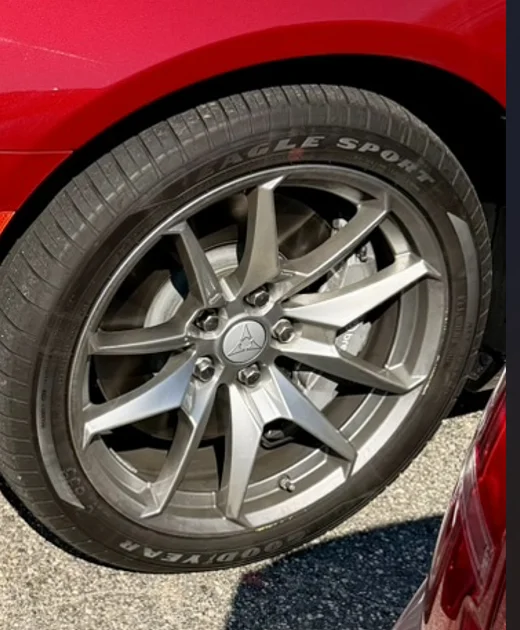

And yeah the 275/40/20 has a range of 9-11 inch wheels the 305/35/20 are 10 -12" The Goodyear Eagle Sports run WIDE. My 305/35 Continentals look like they would fit great on 10" wheels, just beacuse they fit the wheels doesn't mean they won't rub since the 20x11 have a different offset BTW I have some 20x11 spares for winter, was going for 295/40/20 snows, would consider trading for some 20x10,

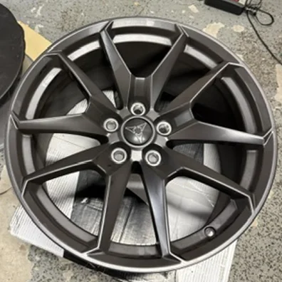

BTW I have some OEM 20x11 spares for winter, was going for 295/40/20 snows, would consider trading for some 20x10, those came on the 797 performance shop car I was planning to beat on the original tires for 2 seasons or so but cut the sidewall on one, sold the other 3 bummer. I considered mounting two on the spare wheels for a sendoff.. But I can get cheapo China tires for some $110 new from Amazon if that strikes my fancy.
So, you're selling some 20x11? I got some Trackhawk style, 20x9, for the 275 for winter to have more curb protection from the curb in snow. DT has a rebate going on now also.
