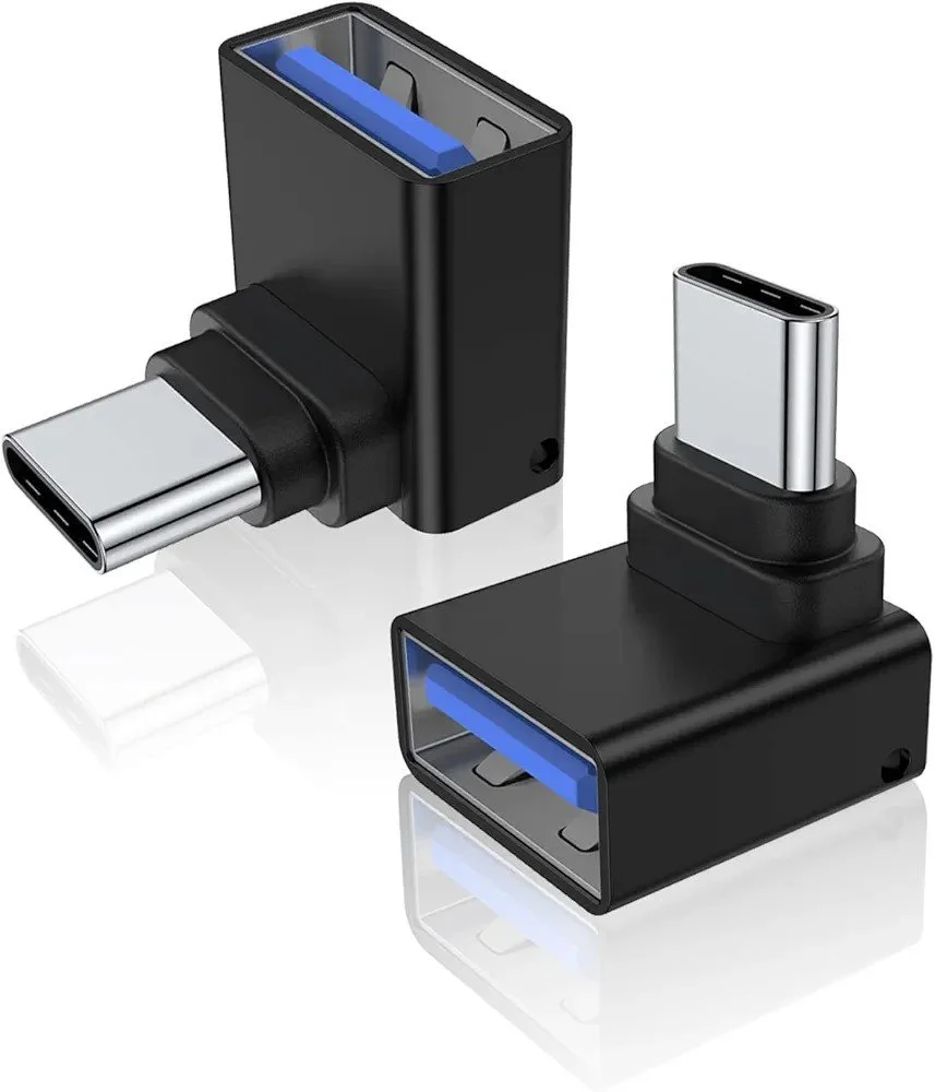

On my Daytona, I use a tiny thumb drive plugged into a right angle A-C adapter in the front port. I have all of my "Car Tunes" on it, and listen to music mainly from it, basically every time I drive the car. Remember there are 2 ports, and the media player treats then separately. I think the lower one is #1, but not positive.

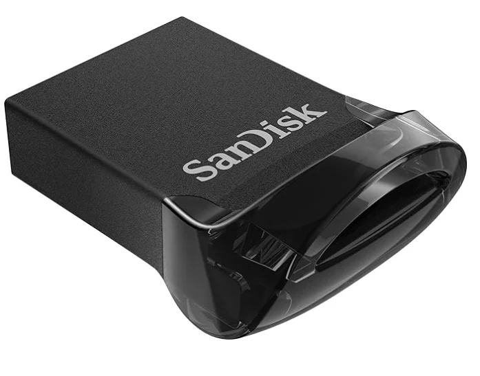

As for the front USB-C port
I use one of these
And one of these TINY Thumb Drives plugged into it. That leaves the top slot for something else if needed.

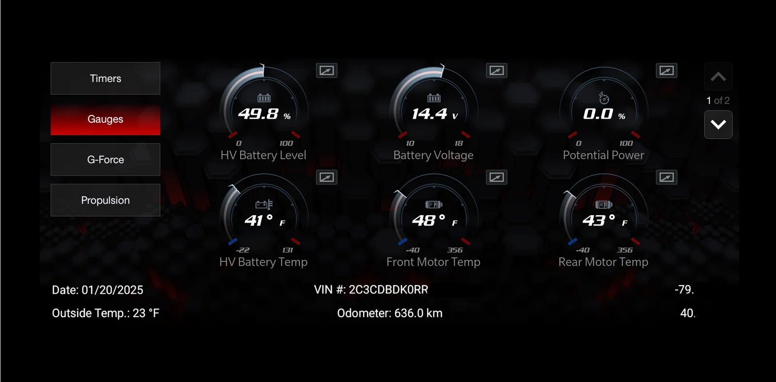

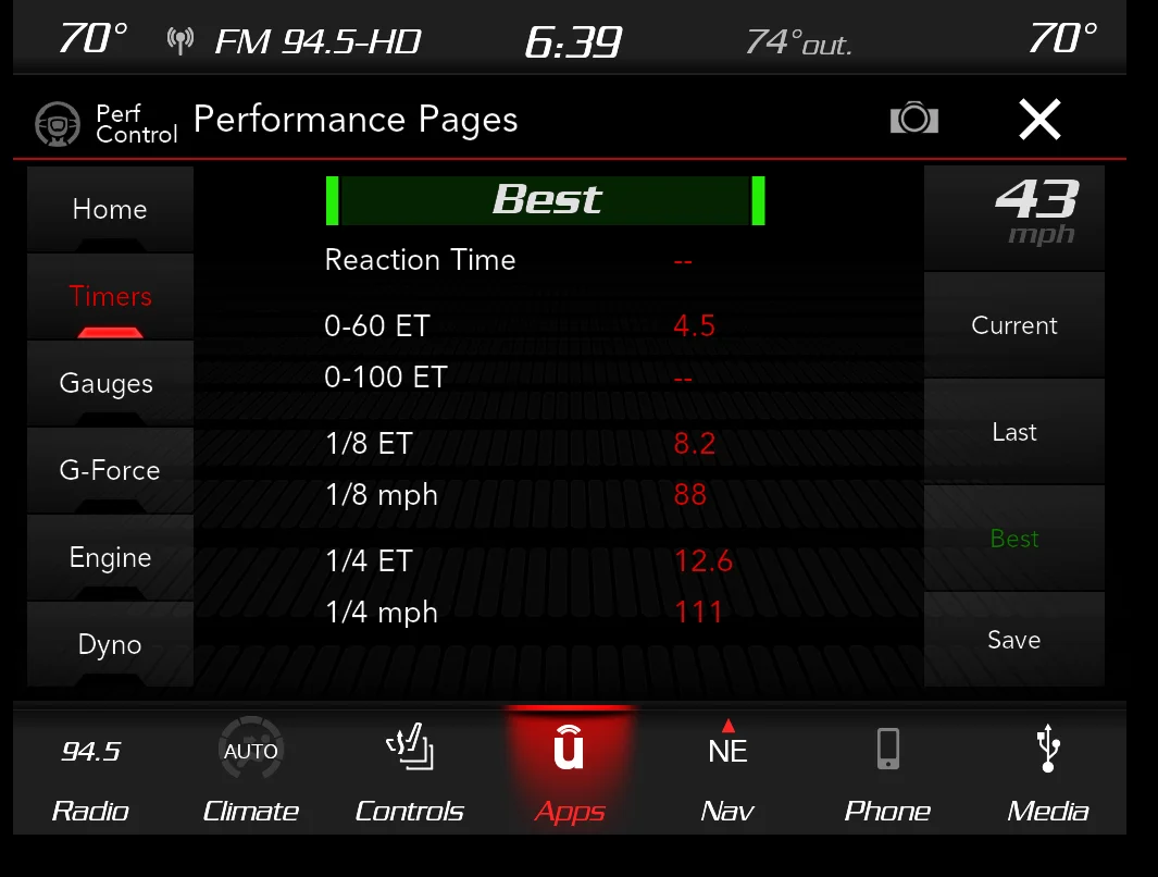

Also, if you have a drive plugged in, then you can save screenshots of performance data from uConnect like this (obviously, different gauges on EV/ICE)
And I haven't checked recently, but it adds your VIN, and Milage and GPS Coordinates to the screenshot. Sometimes in Metric, sometimes not...
Some examples from my car. (Geez, almost 1½ years ago already)
I use one of these
