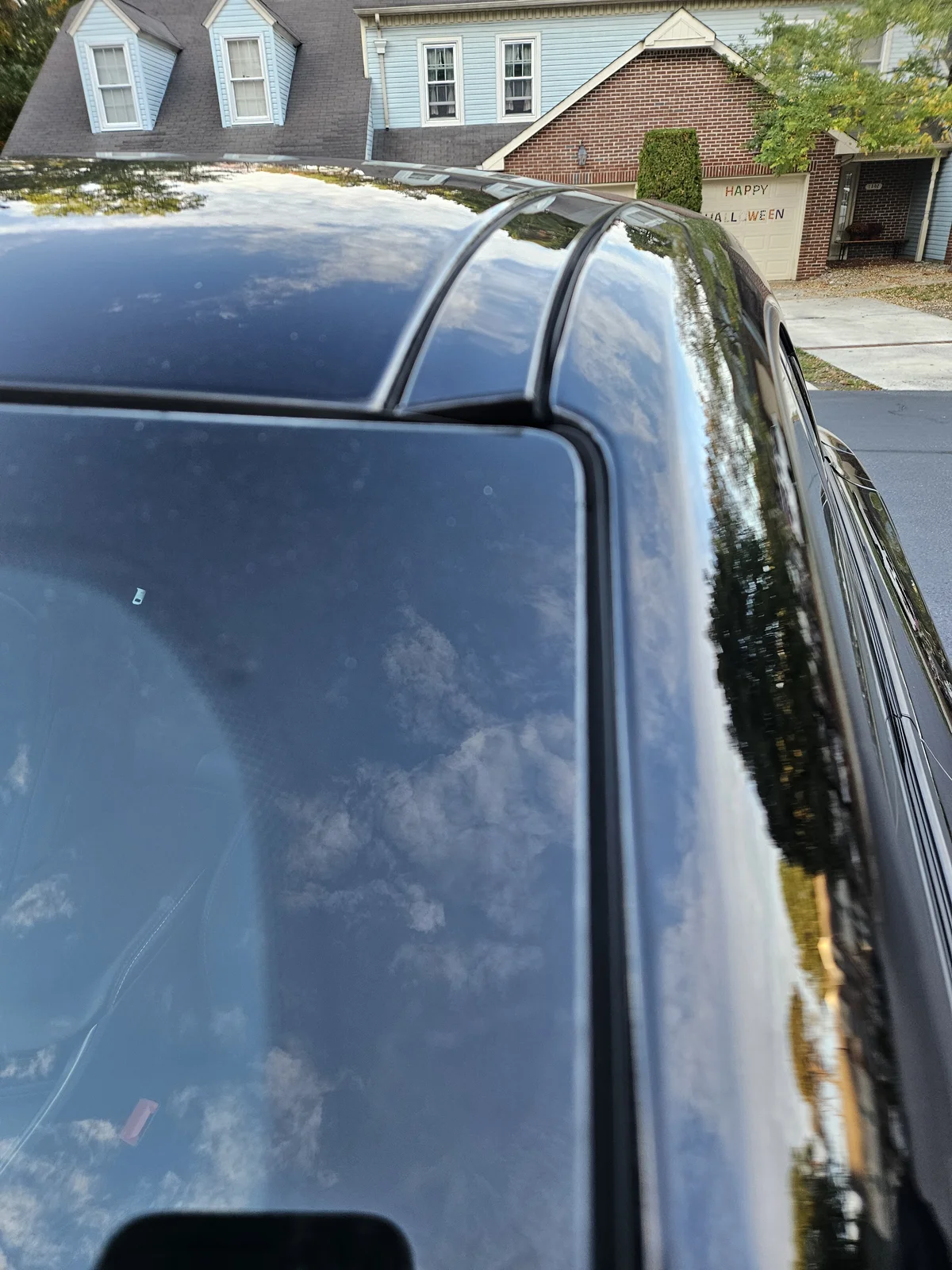

Does anybody have any idea how the roof channel trim attaches? As you can see, over my driver side, the front of mine is crooked/popped up a little. Looks like the windshield rubber is tucked under it wrong. Its been like this from delivery (I see it in pictures), I just never noticed it. Afraid to start pushing and pulling, but don't want to go to the dealer if it is a simple fix.

Using a small jewelry/watch screw driver and a little spray on silicon lubricant, gently work the tucked in rubber back out. Worked for me on a small section at the bottom of the rear hatch window. Not quite like an in grown toenail but similar in concept.
