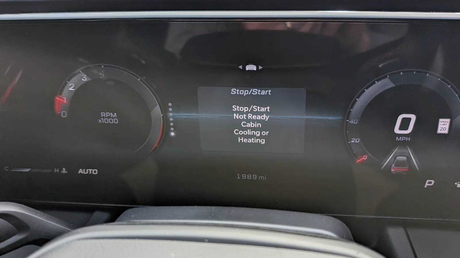

UPDATE: I drove the entire day yesterday with the climate off and windows down. I LOVE the fact that we can turn the fan off and it turns the CC off. The car was fully warmed up, and I made several starts and stops at various places. I probably stopped 10? times throughout the day also. It never shut down one time. I'll check the manual to see if I missed anything.
You should check the Start/Stop page under Vehicle Info to see what it's status is. If everything is good, it will say "Ready". If not, it will show what the issue is. See pic for an example.

I "used" to turn it off like others said, until I realized it was never engaging. Under all circumstances, I have never seen my engine turn off. However......... I have only just flipped 325 miles also.
Could have something to do with break in, but I don't think so. I feel like it happened right when I got the car, and I picked it up at 22 miles.
Wow, ok. Maybe my older Version date?
Maybe, but the only update I've had was the TCM update from the dealer after the car died on me around 2k miles, back in spring. I don't have a lot of test data for you though as I mostly drive with Stop/Start disabled.
I can say that every time I've forgotten to turn it off it will for sure stop the engine on me.
