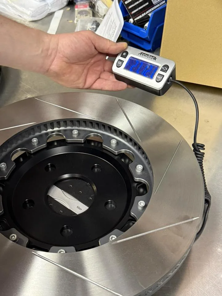

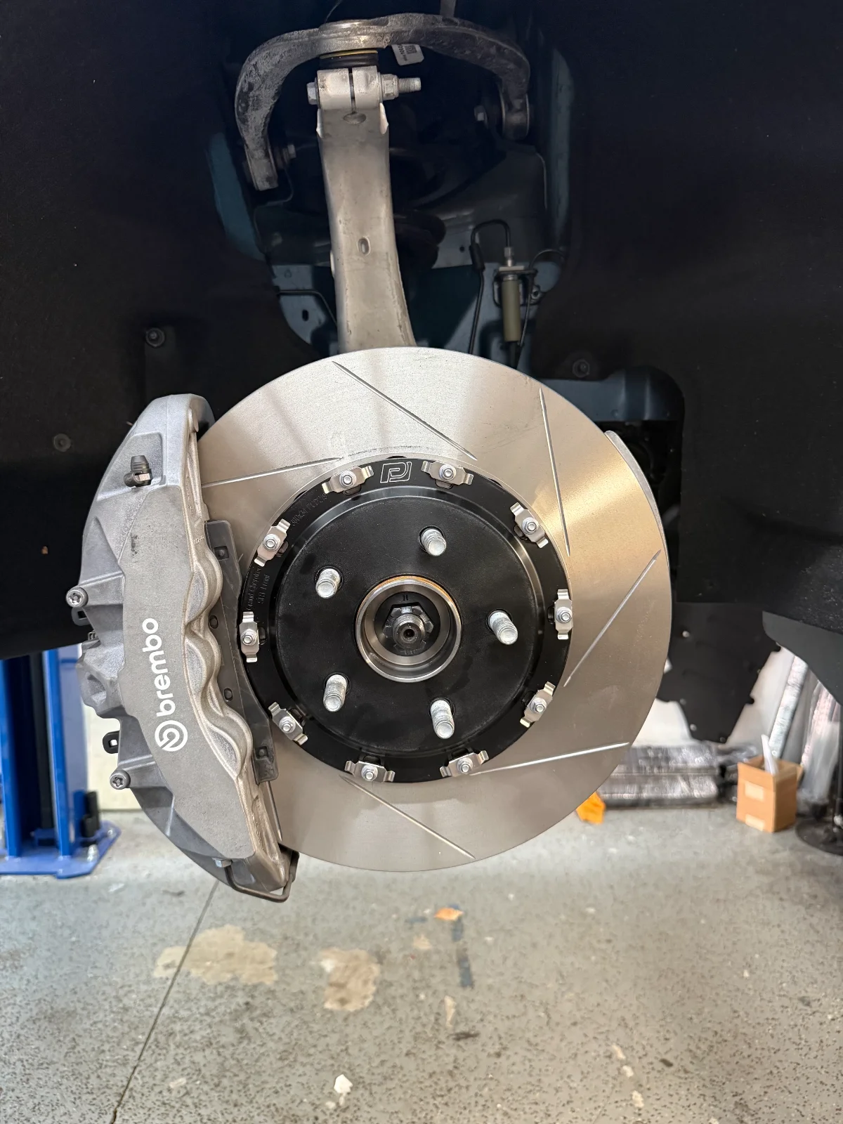

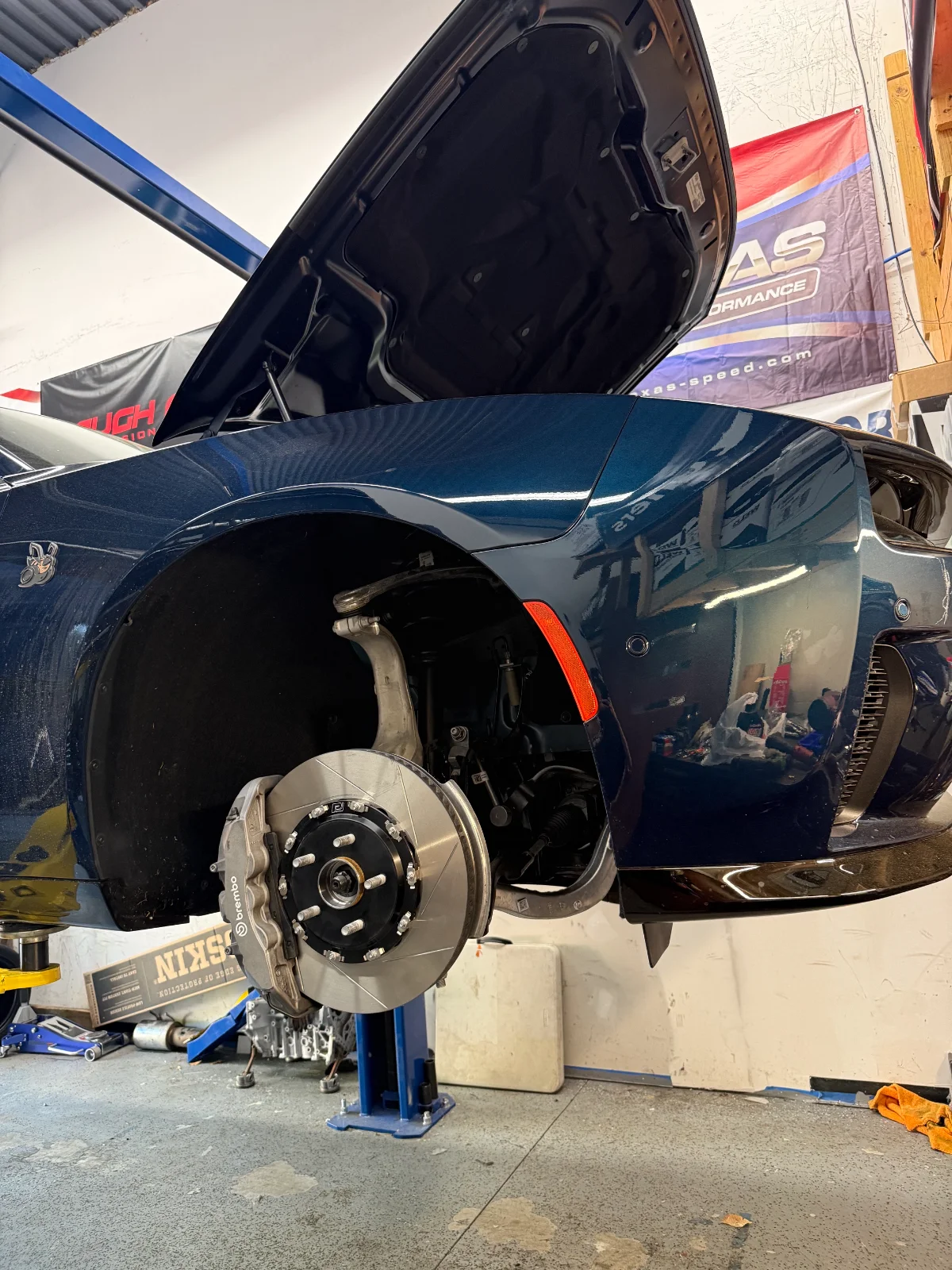

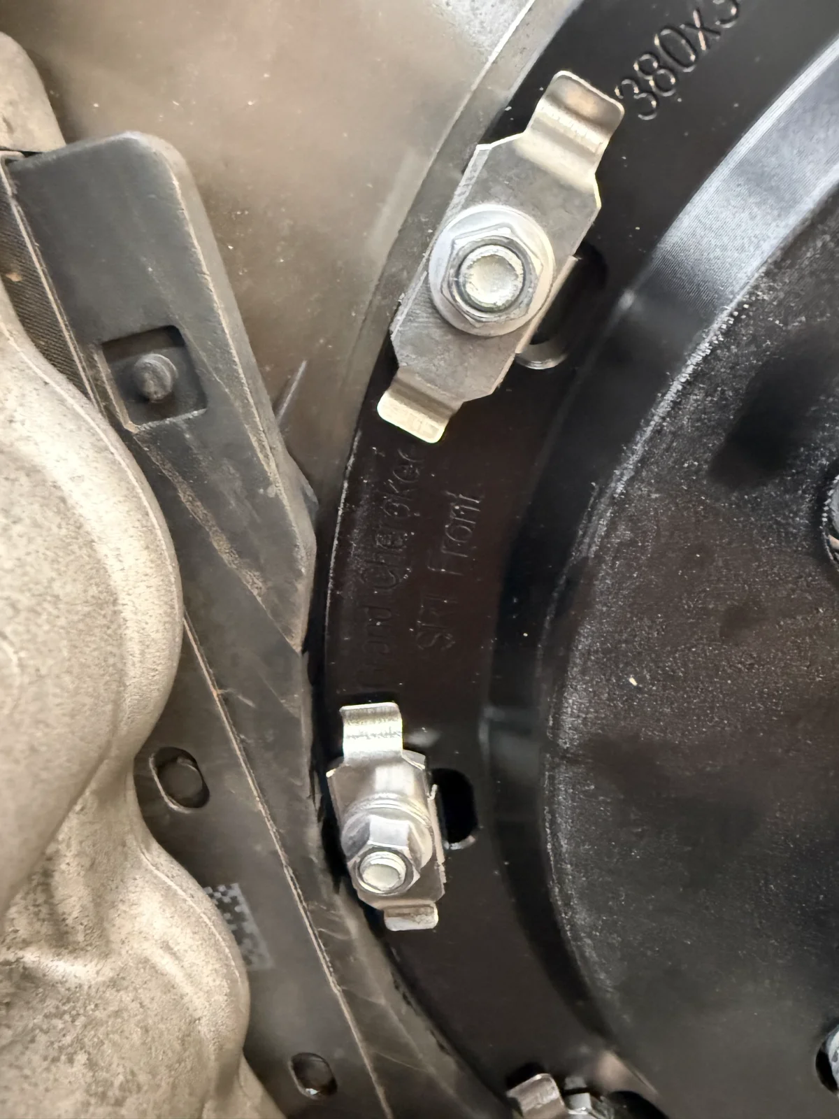

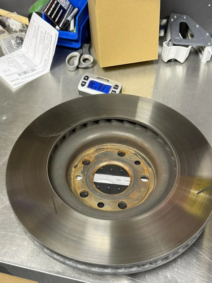

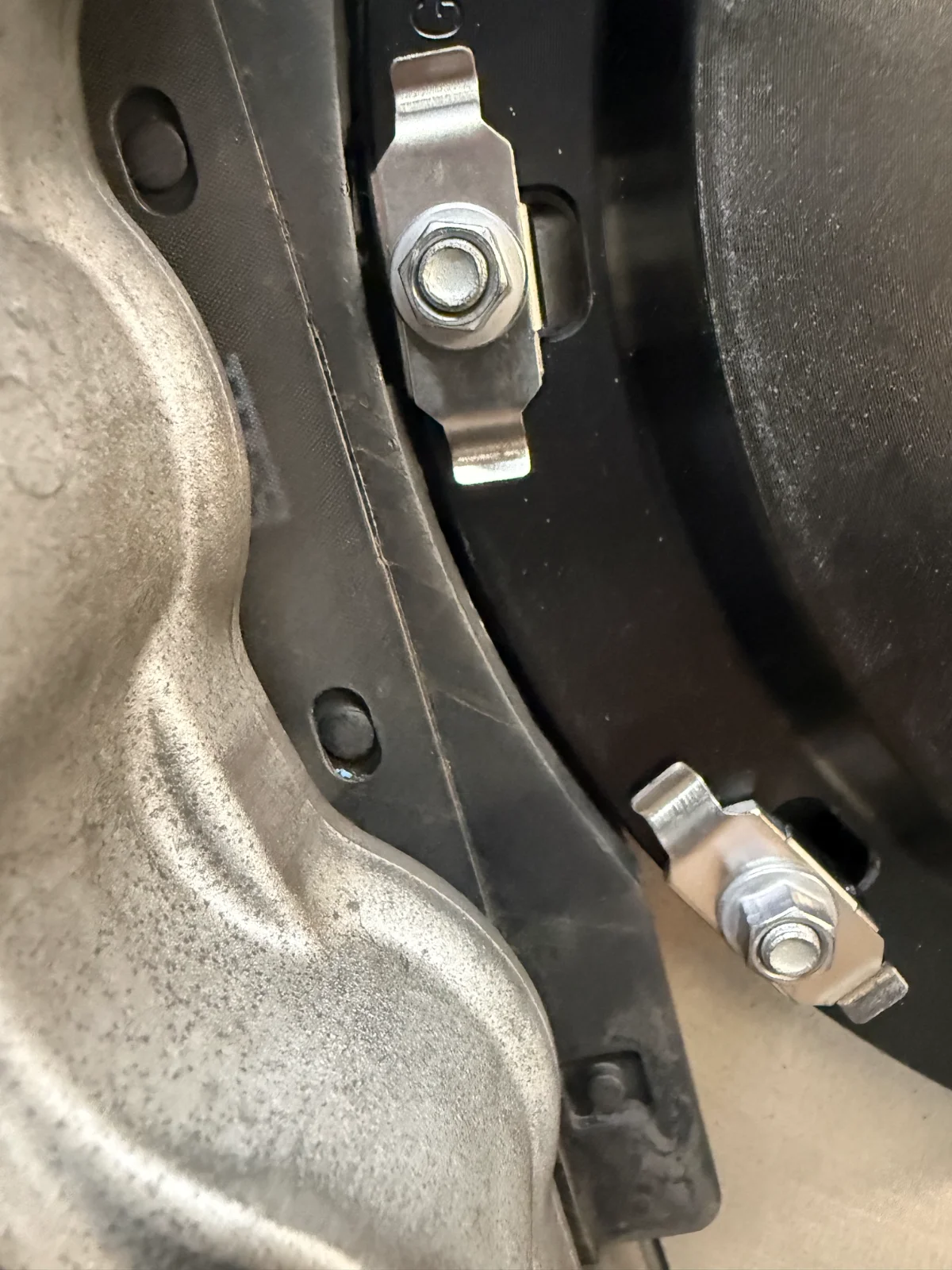

As we mentioned we are working with various companies to help develop replacement & aftermarket performance parts.
A lighter weight 2 piece Rotor we are working on with A company that we are very close with.
Will be putting some miles on these pre-production units and reporting back!

Hey, as long as your in there, look at something for me please. Do the pads slide out the top after removal of the two crossbolts like the traditional Brembos? One model made it look like you had to unbolt the caliper to remove the pads. Secondly, is it the "1405" pad number like the other 6-piston ones? Thanks.

Unfortunately nothing is remotely close to the old cars, this has 4 holes in the top pad, 1405(hellcat) and 6006(trackhawk) will not work. We are working on pad solutions.
It is a radial mount caliper, but pads come out the bottom side not the top.
Nice! Looks like some solid weight savings in rotational mass!
I like the look of them, but to me 5# off the center on an already heavy car, won't justify it performance wise. But I do like the look.
Now would be a good time to paint the Rotors:) Later RJD

We will be coating the calipers, but right now we have them on and off for test fitting different parts we don't want to damage them.

Lots more benefits to a 2 piece rotor than just weight savings! Especially on a heavy car like this, on the previous platform one piece rotors would get cooked pretty easily during spirited driving.
