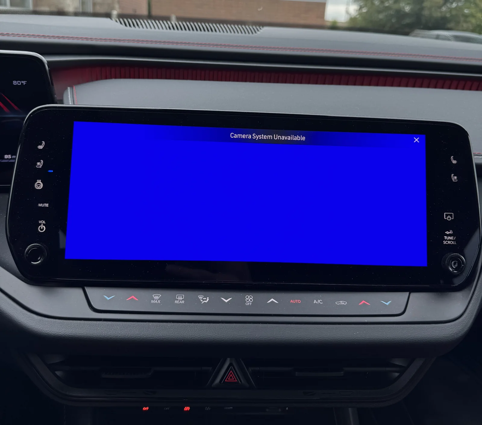

Anyone else get a blue screen that says “camera system unavailable“ when the surround or parking cameras turn on? I got it intermittently today.

So I’m getting it when it auto-triggers the system pulling into my garage or near a building etc. Just kind of weird as it wasn’t an issue ever until yesterday.
I’m taking it in to have it looked at. Hopefully just software.

Had the techs look at it today at the dealership… they said they could log and see the codes from the computer, but not really anything they can do… been working fine all day today.
I thought the UConnect update was supposed to fix this 💩 🤬… restarted car, restarted radio, park, reverse, park, reverse…. Nothing it’s gone.

So that wasn’t the most recent Uconnect Update? I had that installed a week or so ago. I guess I’ll take it by the dealer if it’s still doing it here in a bit. Hopefully it just didn’t get “that update”. This thing is a pain to park without the surrounding cams.
My dealer has not mentioned about bringing it in as yet. I have no issues so far but I will check with my dealer tomorrow. Later RJD
I don't recall anyone else seeing a blue screen yet. Is your version the 43.12?
Yep, I’m on the latest UConnect. I had this happen before the latest UConnect months ago and assumed that it would be fixed with the update. Then I get it again not a few days after the update.
So now I’m wondering if the fix is a separate flash or if I have a completely different issue. The outage yesterday survived restarts, but cameras came back after the car sat for a couple hours off. 🤷‍♂️
I’d take it into the dealer, but last time they just “could not reproduce”-ed me and I wasted a couple hours. They did say it recorded codes at least, fwiw.

Was at my dealer today and they said it's an OTA fix but you may have a different issue. Mine has had the OTA fix apparently as I have not issues. Later RJD
Got my notice in the mail about the back up camera. It says OTA update if you can not get it done that way they say to bring to dealer and if necessary update the radio software . Later RJD
