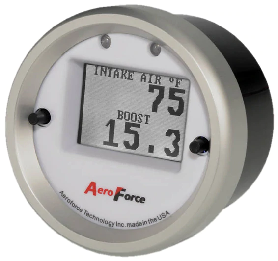

Yes, try and see what works good. I've been using one of these, that plugs into the OBDII port, to monitor gas. I have it set to show short- WhiteWhiteBrushed_912db70c-2af6-4255-a18c-46f74a97b927_960x.webpterm and long-term timing retard. It's amazing how different the "same" octane gas is!
