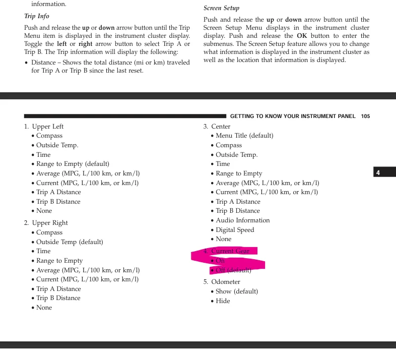

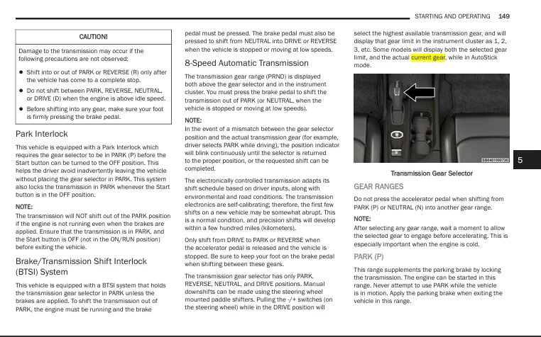

It is mentioned a couple times in the manual. Search for "current gear"
