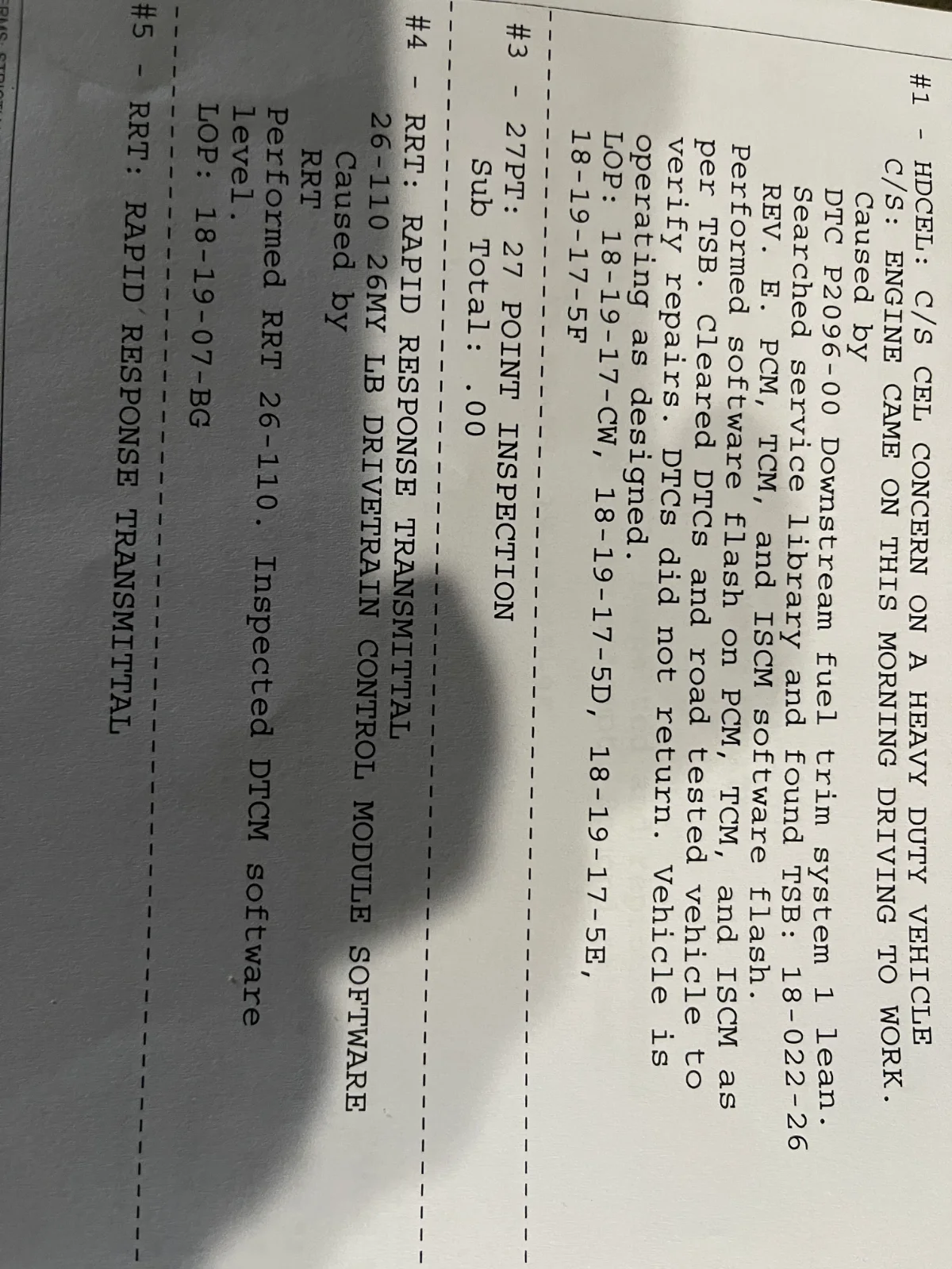

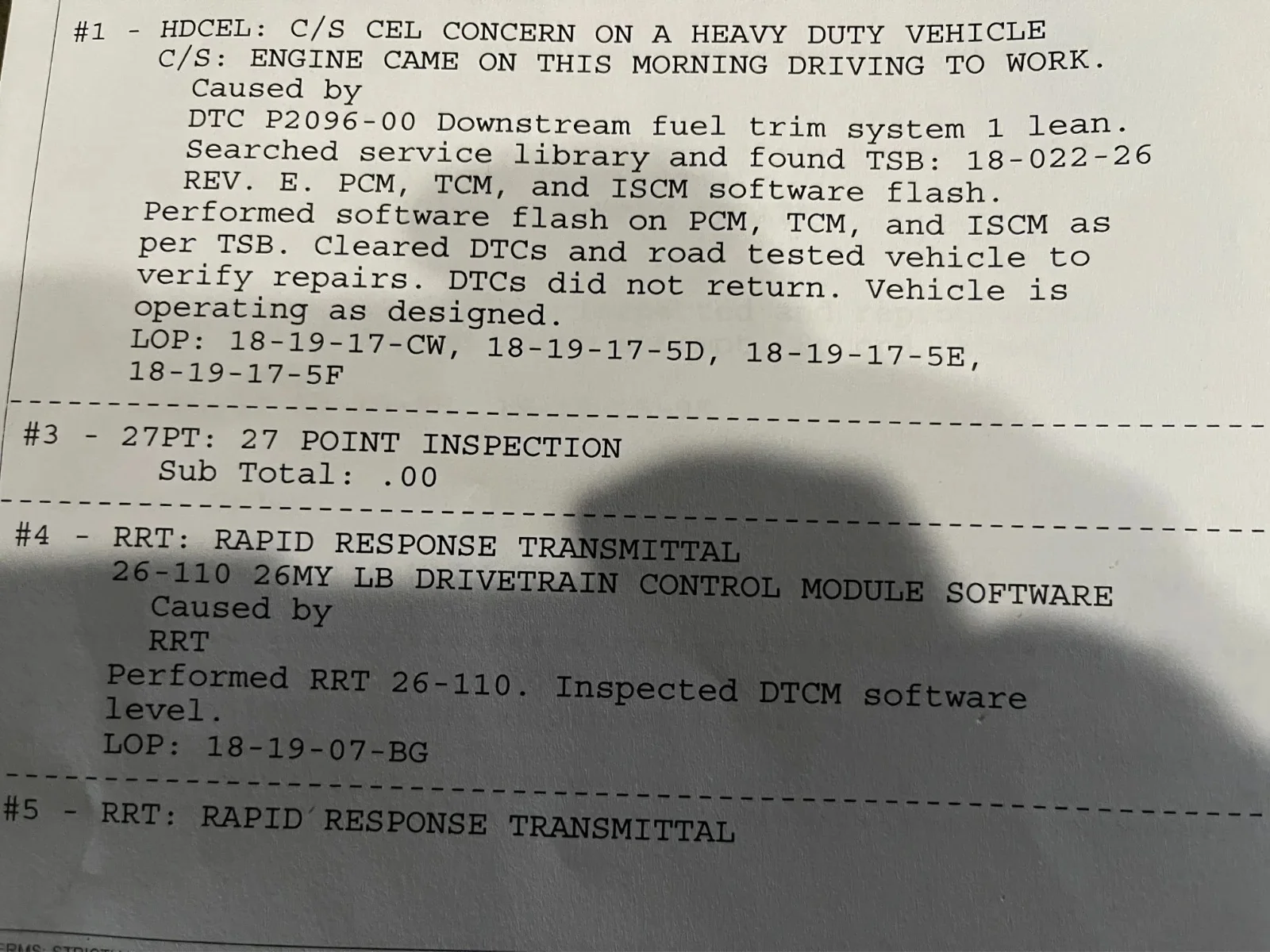

Just broke 5000 miles without any problems and the damn check engine light came on. It’s not running any different and the dodge app says everything is green. Got an appointment for it this morning.

I had Rev C applied at ~800 miles for a check engine light. All good so far with ~1,500 miles.

I dropped mine off Monday Morning and got it back Friday afternoon. But my car is flagged in their system. I had to get a whole new transmission after 5 days. lol Otherwise I heard a couple of hours.How long does it usually take to update software? They said the car needed three updates. It been about three hours now.
Thanks
Said it popped for a down stream fuel trim and I guess they are having trouble with one of the updates.
