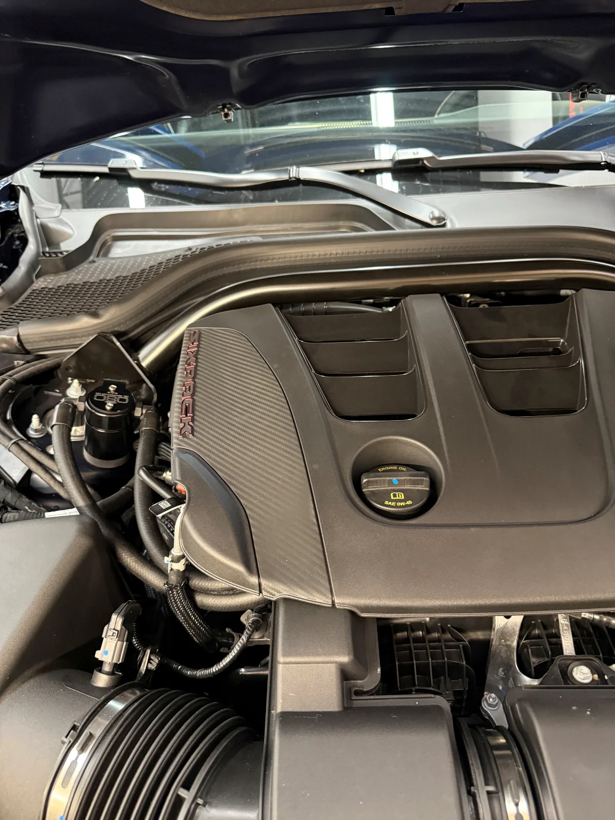

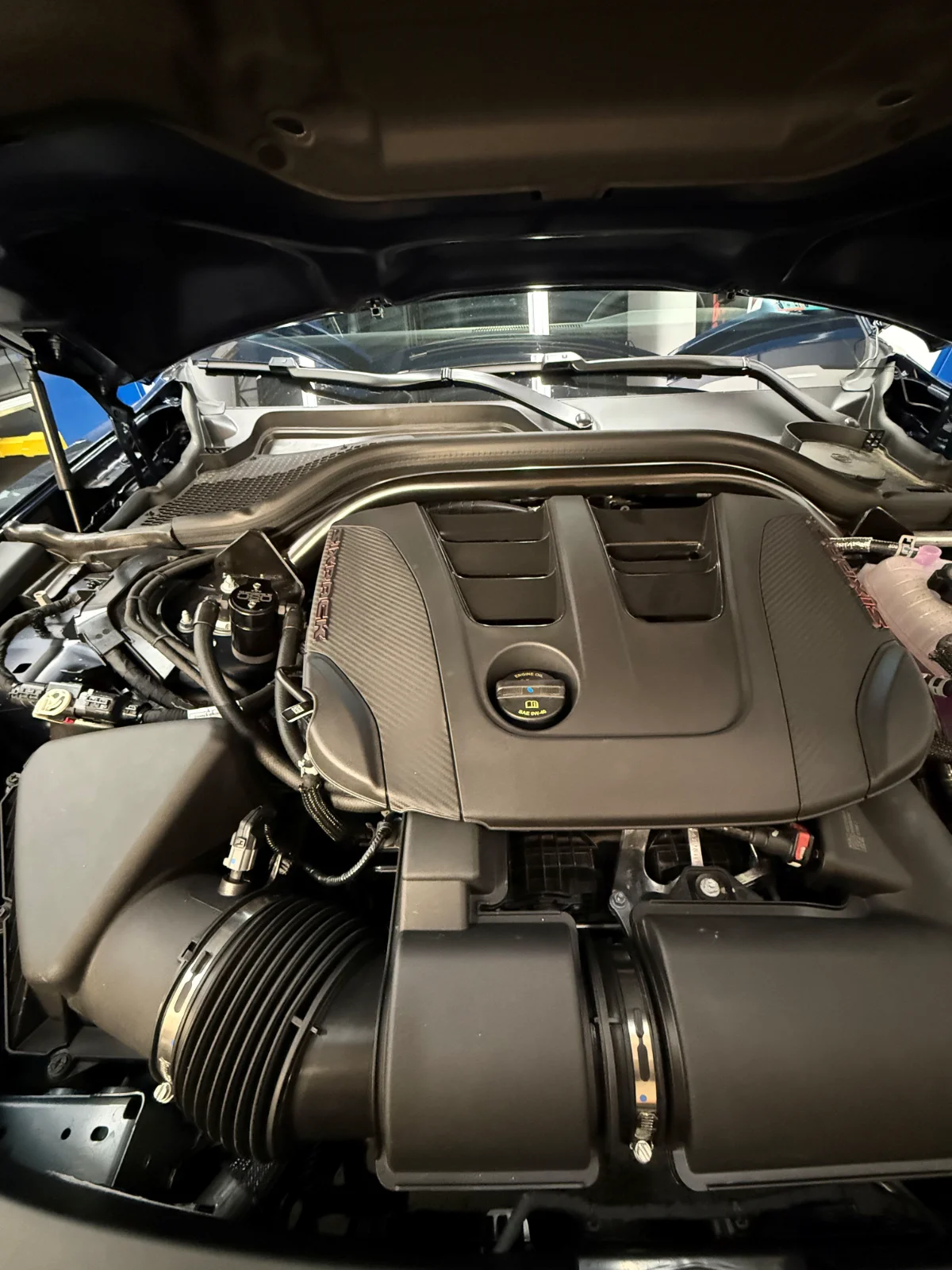

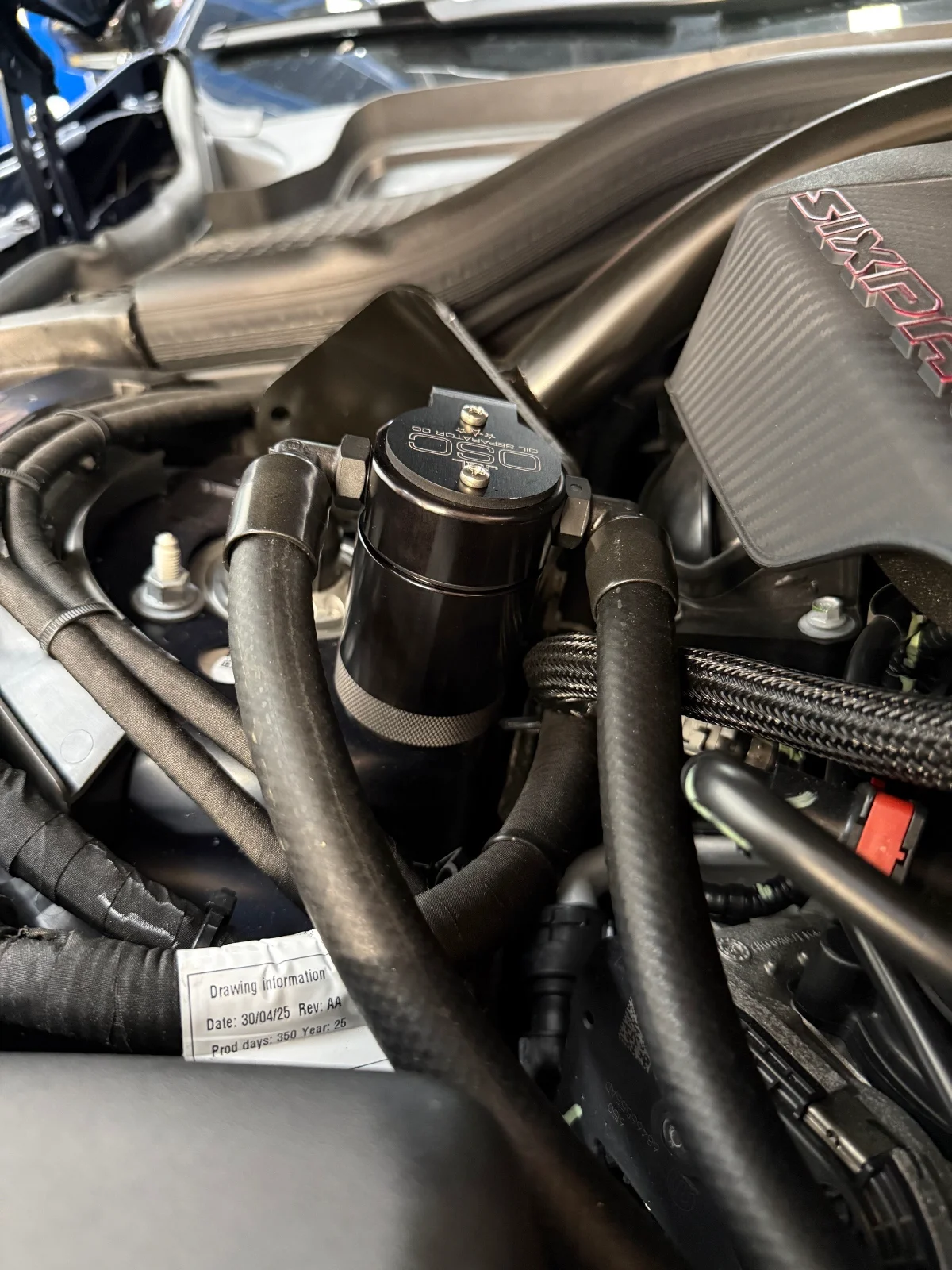

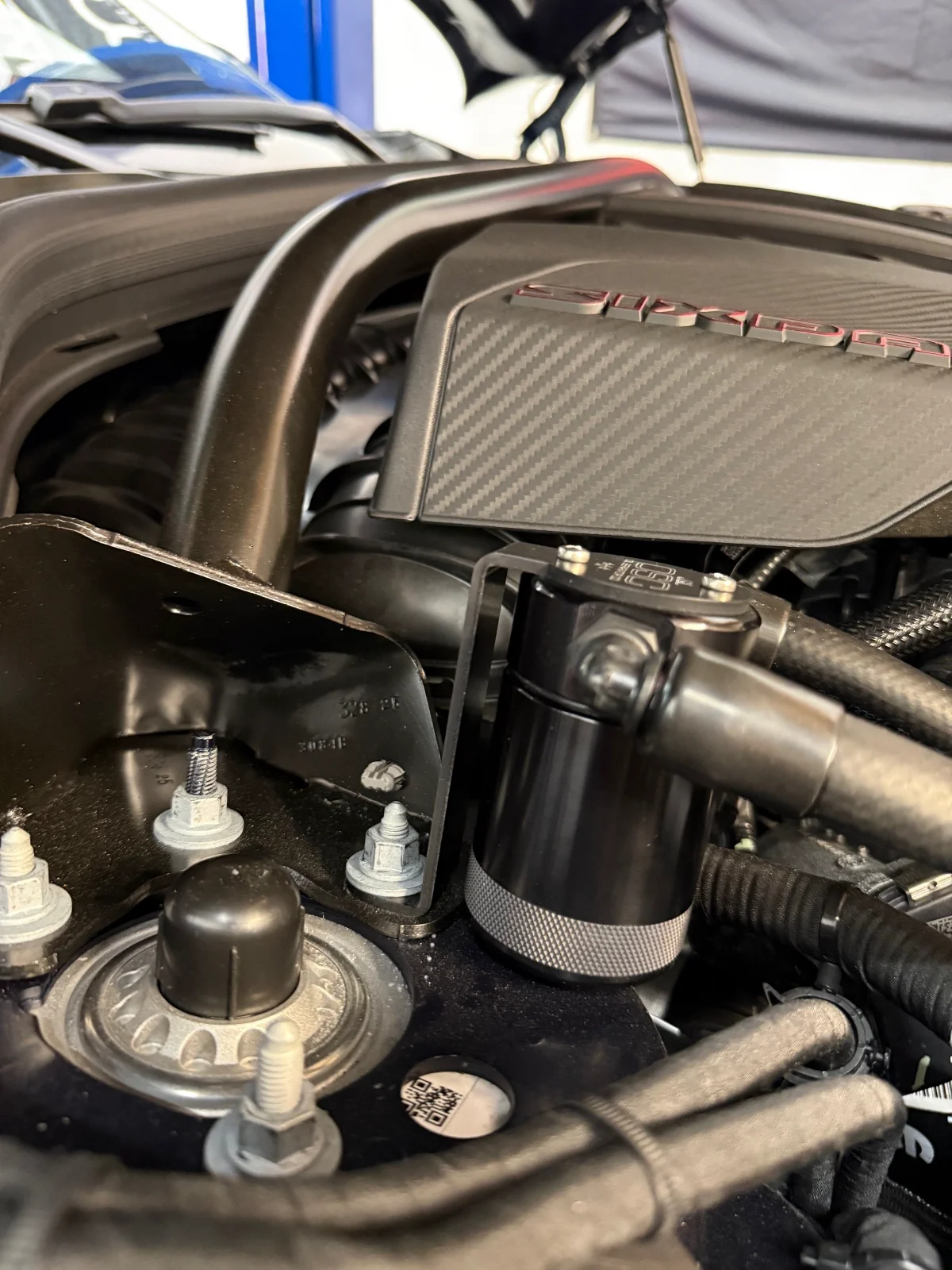

Hey Guys & Gals!
I put together a catch can setup using a few different parts from different vehicles utilizing a J&L catch can.
Any interest in these on this platform? It is angled due to clearance issues and you would have to unbolt it to drain it (1 13MM nut). Would that become a large inconvenience? These typically run $159-$169 from J&L.
I am trying to gauge interest in these at this time, I utilized some off the shelf pieces so that we could get this pushed into production sooner rather than later.
We sell a ton in the RHO community (same engine) and we have found an oil catch can is certainly suggested on the hurricane engine, it is great to see what ends up in the can not ending up in your engine.

Forgot to add this:
For comparison we are trying to offer something a bit more affordable vs the current options out there.

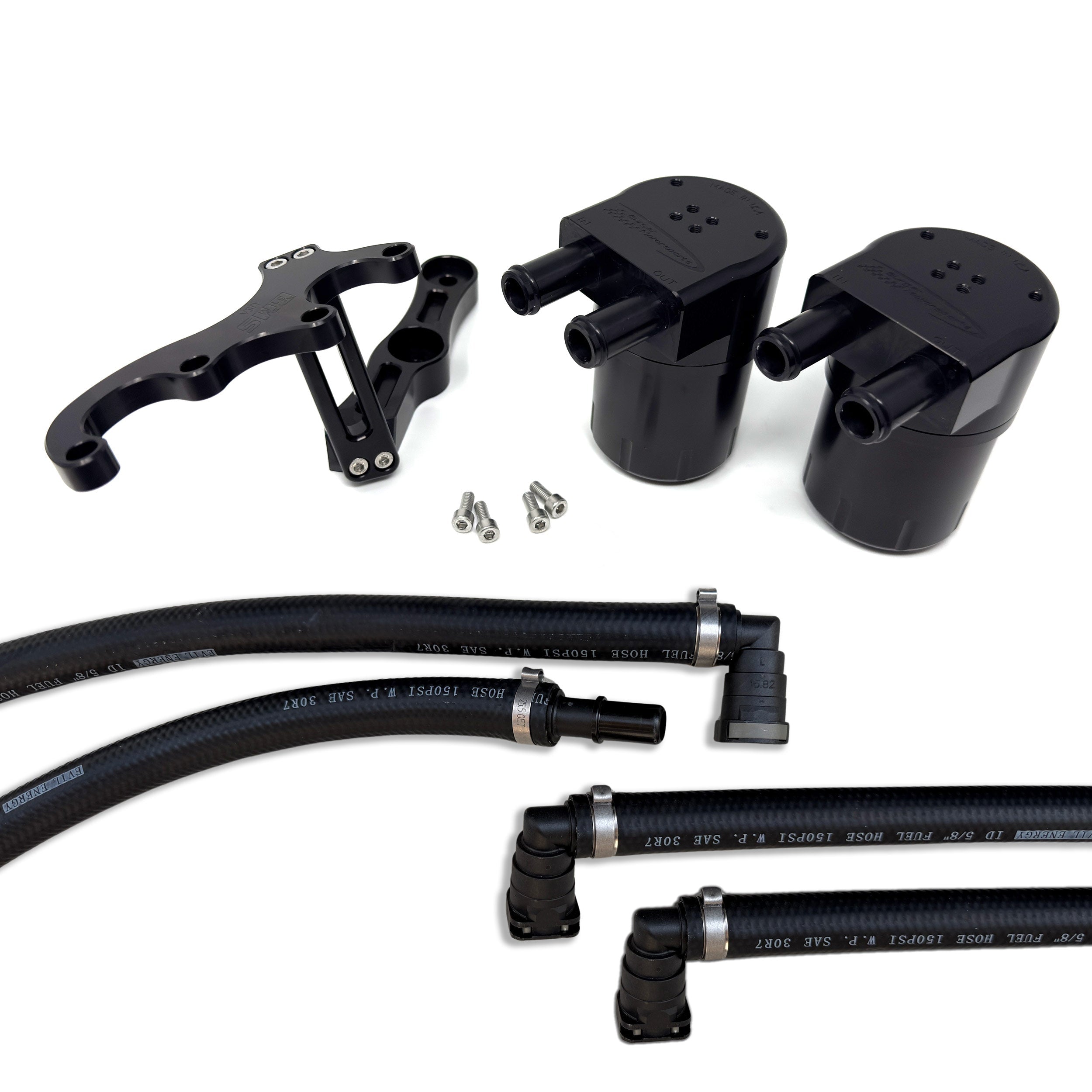

If you plan on developing a double like them I am guessing you would get plenty of people grabbing them. I will be grabbing the dual can shortly.
We are a dealer for them, and I can sell you them as well BUT, personally I have found dual catch cans on these & hemi's to be not so effective as the one can doesn't trap anything so it's just sitting there looking pretty in a sense Lol.

I always had one on my Dodge Magnums- Billett Tech made a nice, affordable aluminum one that worked well. This engine a can would help mitigate carbon buildup on intake valves for sure. I’d say location of mounting for access to drain is probably most important and included hoses to connect since this engine is a little more complicated and most won’t go and splice into an existing PCV hose for warranty
