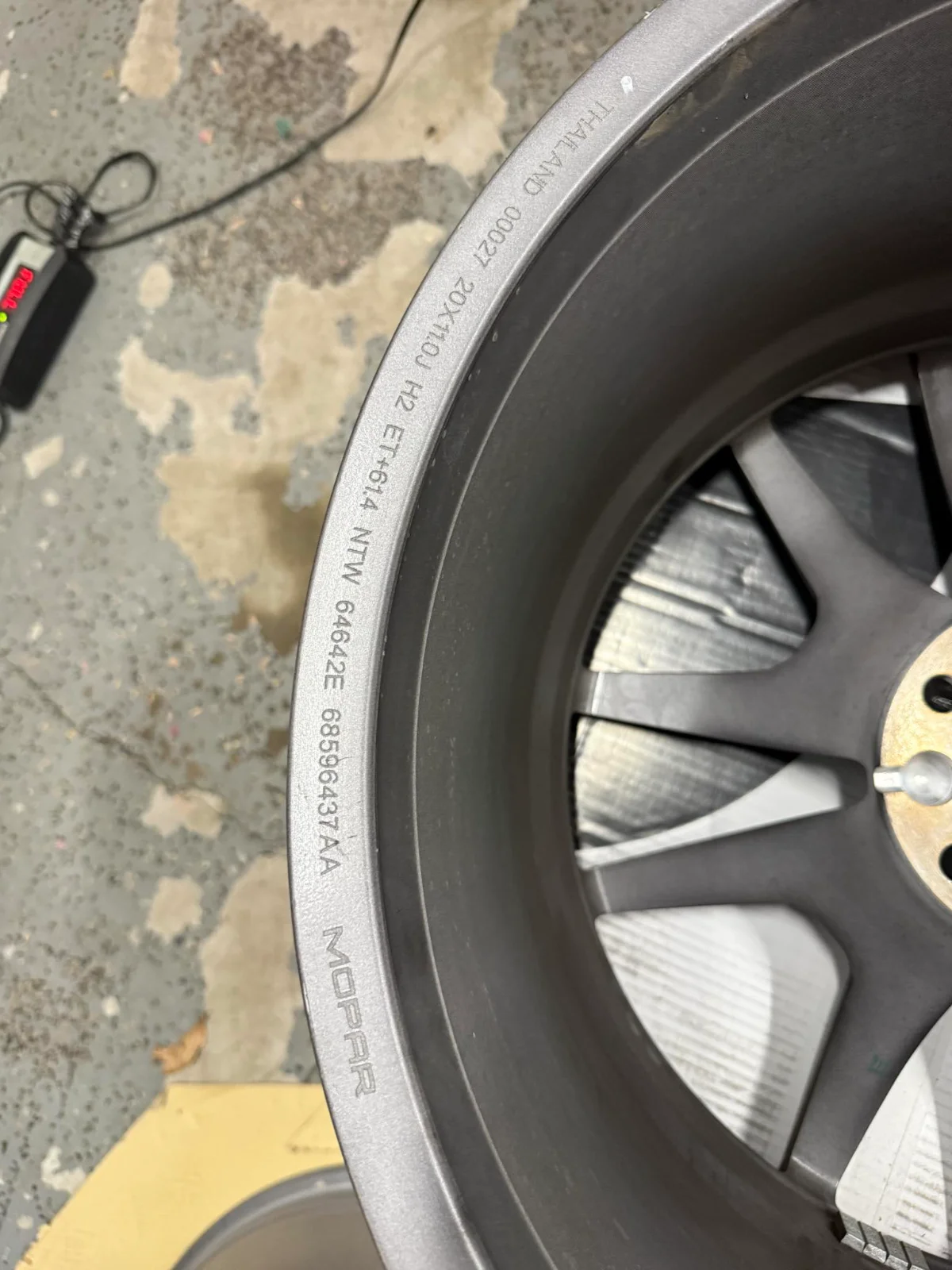

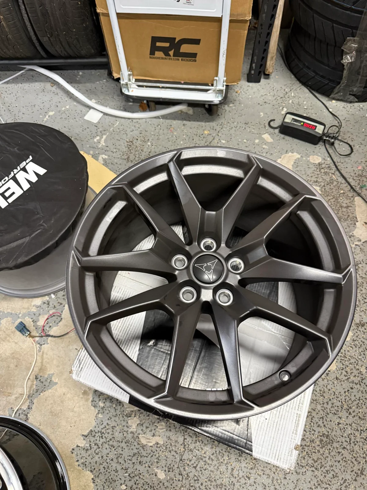

I have learned some unverified information. The Trackhawk wheels 20x10+50 looks to be a close match to the Base Scat wheel The 61.4 offset on the 20x11 matches an actual photo so promising. Edit, cleaned up the messy hyper link
[Peter Tainer]the Scat front 11in wheels have a 61.4mm offset, rear 11.5in wheels have a 70.4mm offset. The R/T Plus, Blacktop 10in wheels have a 46.6mm offset. My understanding Dodge is reusing the 10in R/T wheel for all 2026 Sixpack Scat Chargers as the base 10in wheel (both the Diamond Cut and Black Luster) so brembo clearance isn't an issue.
the jeep info was here https://www.threepiece.us/blog/jeep-srt-srt8-trackhawk-wheel-fitment-guide/

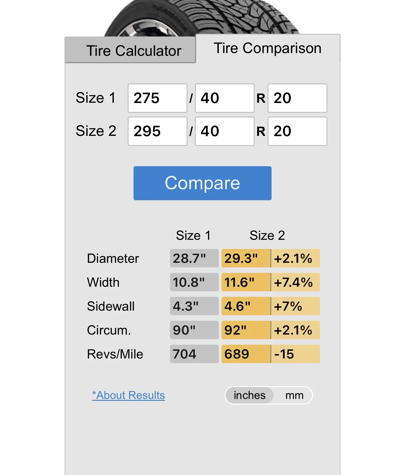

So the 20x10 trackhawk wheels should be fit if not exactly the same I ended up getting a deal on some 20x11 OEM scat wheels I was planning to use for the winter. There’s only one snow tire for 305/35 6 for 295/40 and 15 for 275/40 which does fit on the 11 inch wheel but 295/40 seems a better fit with one blizzak W rated and one 275 was y rated “

LOL! Yes, they call them "winter" tires now. I'll stick with my 275/40 because the thinner, the better. Be careful of the offset for Jeep/Durango wheels though. Tire Rack shows all the options for the Daytona and Six Pack.

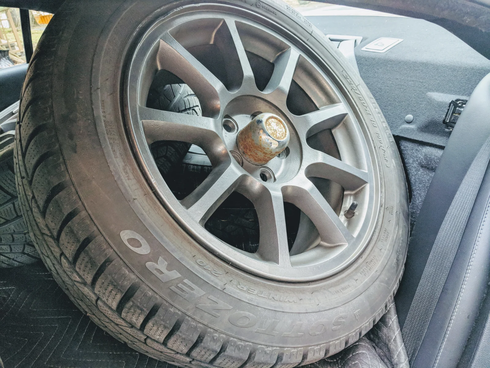

I had some Pirelli Soto zero on my Craigslist wheels. Drove better than the RSA-2 the car came with and great on sloppy highway but didn’t climb hills well with the open RWD charger R/T I’m Leaning to the 295 /40 W rated bilzzaks for the 20x11 wheels I’m getting

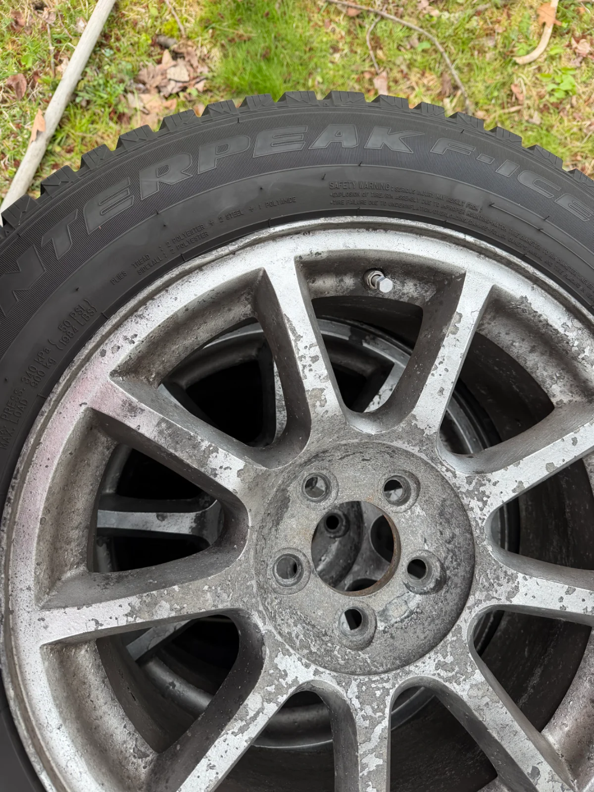

I just pulled off Hankook F-ICE did great last year lots of snow
