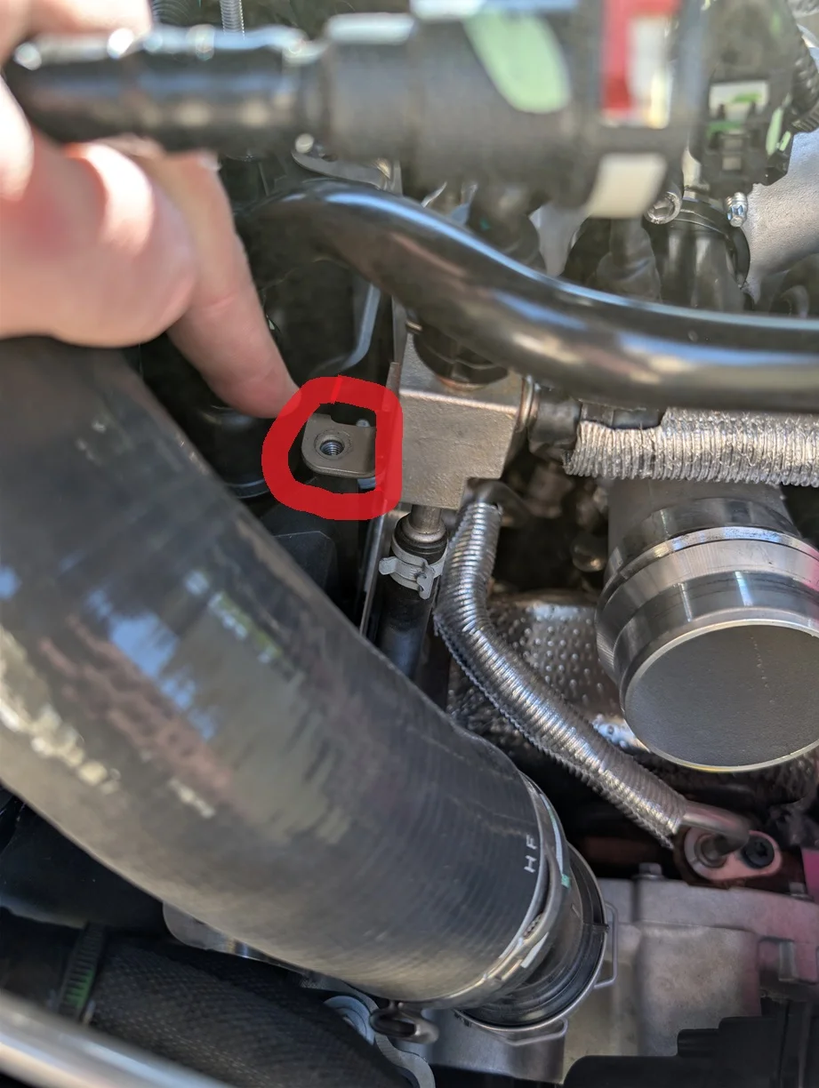

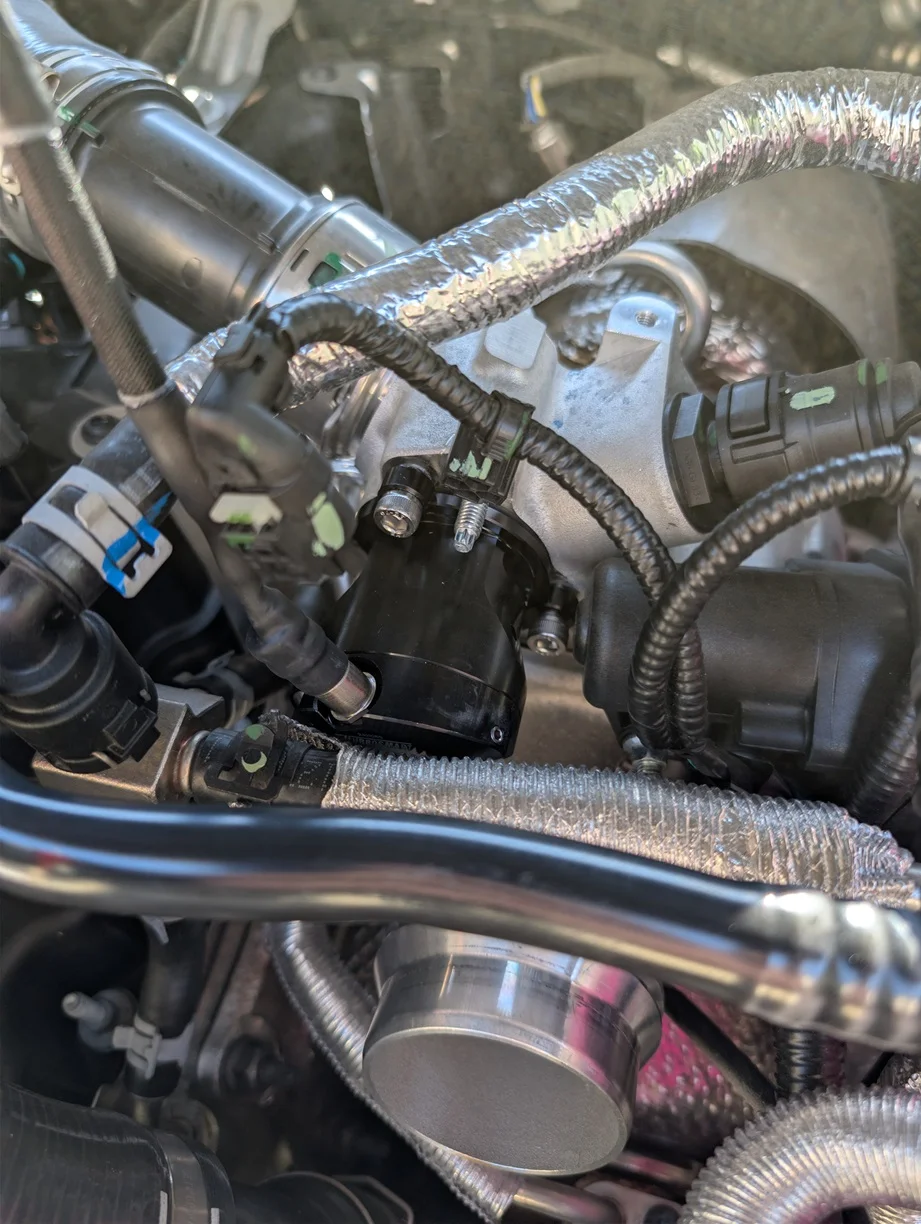

Install is complete, took about 40 minutes without instructions. Pretty straightforward overall. The only hiccup was the top diverter; the hoses up there are really snug. I pulled one T30 screw to get the clearance I needed, and once the valve was seated, everything went in smoothly.
I’ve got the setup running 50/50 right now. The spool‑up and whoosh are definitely there, just not super pronounced at this setting. What I am noticing is that it’s managing boost way better than the stock diverters. There’s noticeably more stability, which should give me some extra headroom once I throw a JB4 on it later. Solid upgrade in my opinion.

Top: Screw to remove to make install easier.
Top:

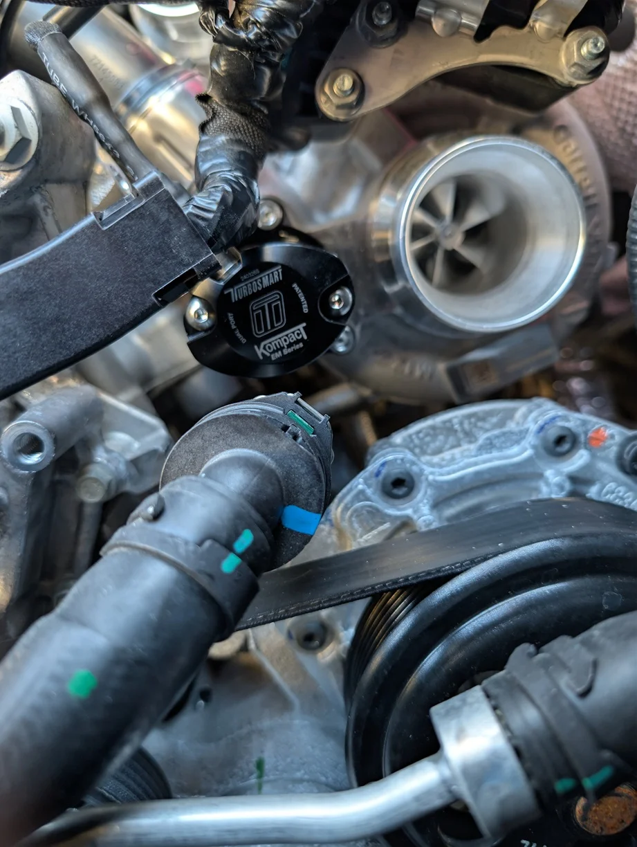

Bottom:
