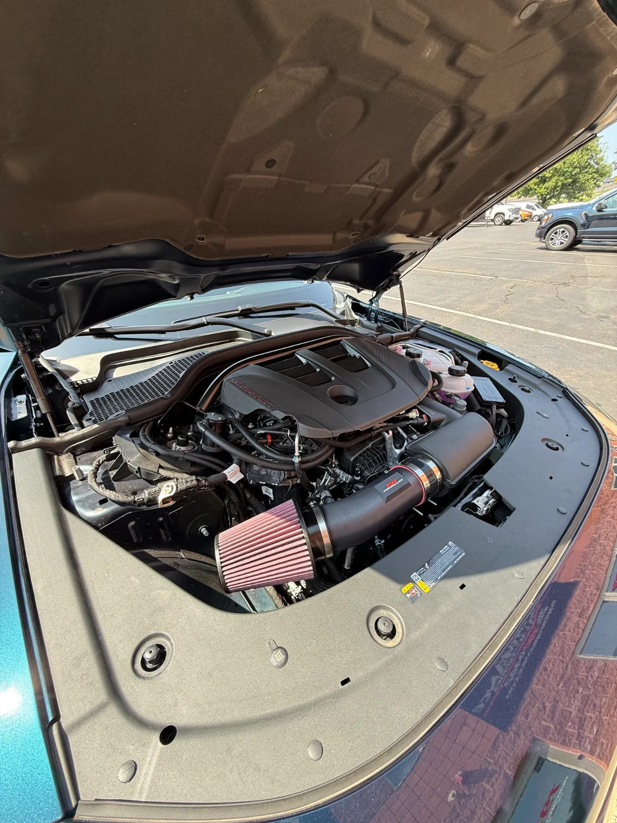

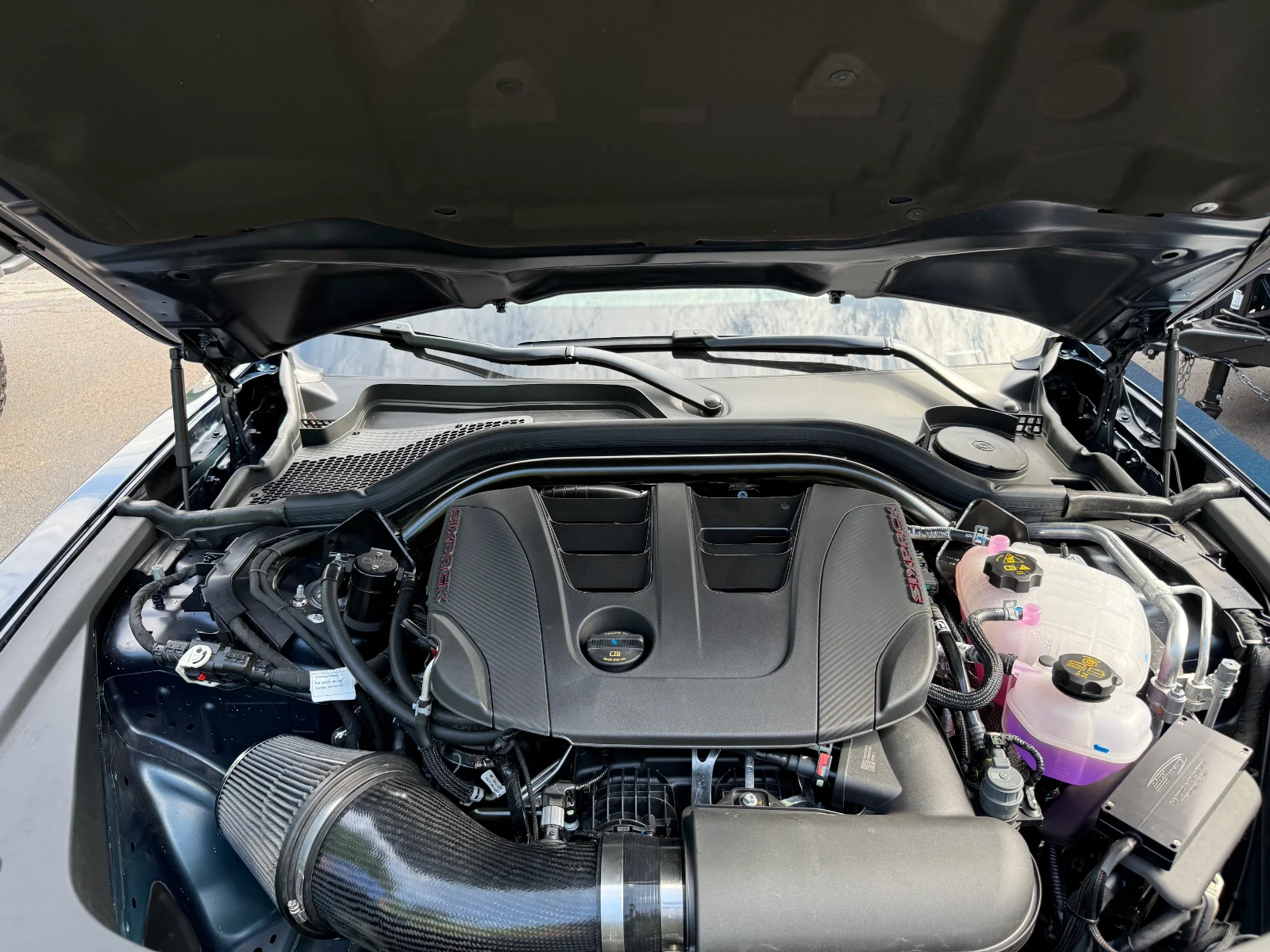

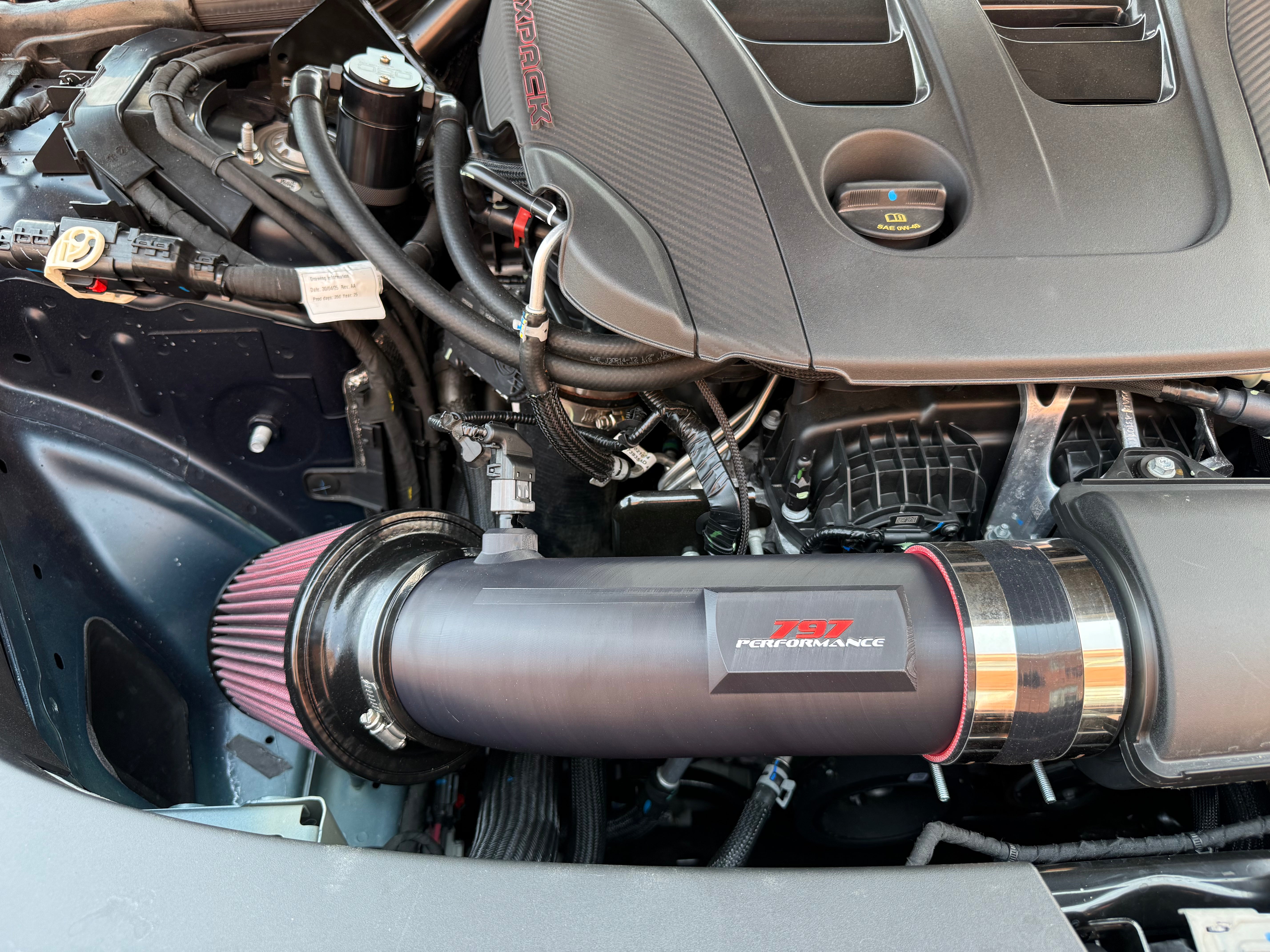

Here we go
Leg Maker Intakes -
Intake noise is present, unfortunately the test filter is a dirty filter that he sent. Some modifications are being done and we will post pictures during the next revision.
This is a carbon fiber tube hand made in Florida.
FAS Motorsports / 797 Intake - Will be shooting for $299 Retail Price.
This is a plastic intake utilizing an S&B Air filter.
We will make a revision to this intake to place the filter closer to the duct to try and take as much air as possible in.
Turbo / intake noises are present with both(enough to make me smile from in the cabin) , making the overall driving experience more pleasurable.
Both of these intakes we saw around an average of 20 degree higher intake air temp(IAT) than ambient air temp which is about average, monitoring via the JB4. So I'd retract my previous statements as this car has a pretty functional air duct coming directly from the right side bumper vent right to the air intake.

So far so good! Got 150 miles and the car is happy. Have a revised air tube going on today. (Improved IAT sensor fitment, and also extending it a little closer to the air inlet and adding ribs to ensure a snug fit.)
Car did a 4 hour trip this weekend while monitoring everything. We are getting closer to production!
Updated with a sound clip as well, likely going to do some dyno pulls with JB4 & without and with stock intake and without so we have the data available too.
