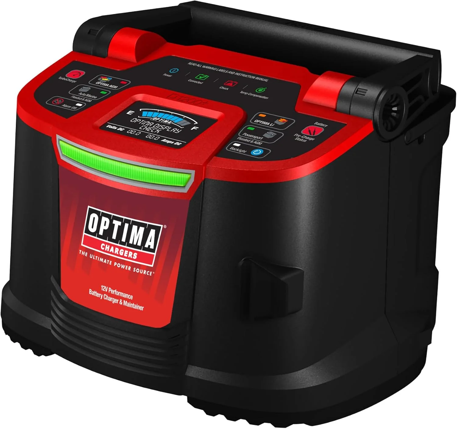

I picked this up on Amazon... I hardly ever drive my Jeep and the battery gets low sometimes. I need to give it a charge.
I know the battery is a regular AGM, but there isn't really a regular AGM specific setting on this thing.
It has:
Optima AGM
Auto/Marine
Optima Li
Powersport
I'm figuring for a regular AGM battery any setting except the LiPo option will work... but I can't really find a clear answer anywhere. Anyone know?
Use the Auto/Marine setting. LiPo is only for Lithium Ion batteries.
Will do. I figure the Optima AGM is probably the same too, I mean, what could be the difference if they are both AGM batteries?
Optima uses a SpiralCell technology instead of flat-plate construction found in most AGM batteries. They also use better materials, which can lead to faster recharging and higher cranking power. I would think their charging parameters are higher than those of a standard AGM battery. So to be safe, I would just use the standard Auto/Marine setting.
Perfect, thank you for the help! They sure could make the descriptions on the charger better, IMHO.
Doesn't POWERSPORT say "Flooded and AGM" or am I missing something here?
LOL, I never noticed that. It does.... my eyes just completely ignored that part when I was hooking it up.
