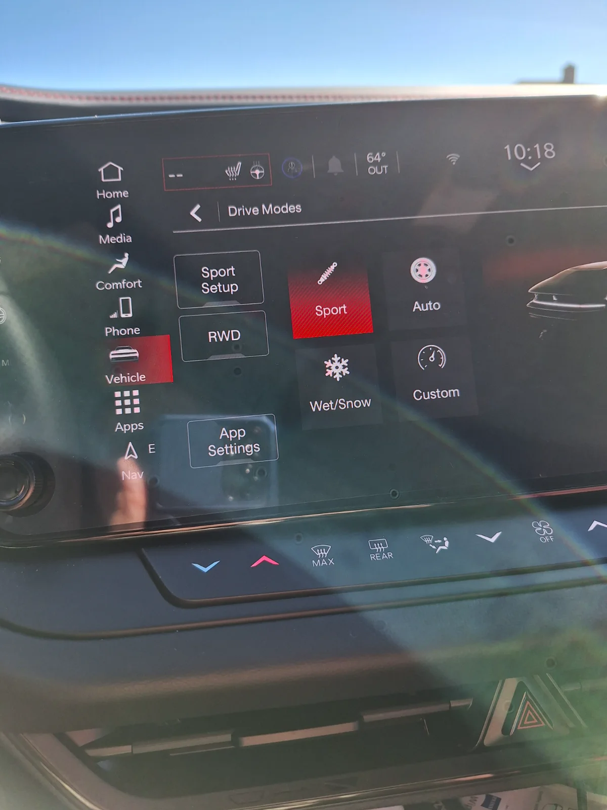

I was able to break loose with the 305's and TC -FULLY- off in RWD and hard floor to engage the propulsion.
I was also able to break loose forgetting I was in sports mode after it snowed/froze.
Both situations were interesting.
I just did it. You pick SPORT, then RWD shows up and the TC is off. Mine easily turned the rears again at 1500 - 2000 from a dig.

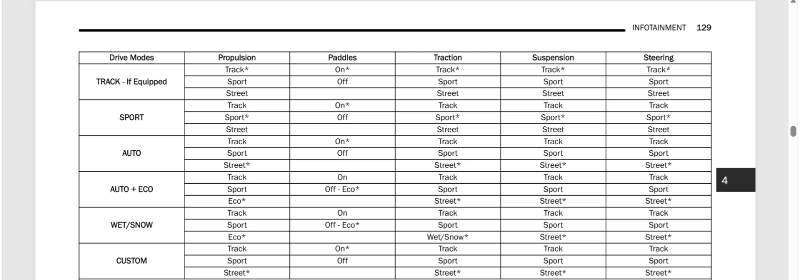

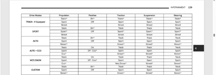

Antone else notice in the owner's manual that we have three levels of propulsion in all modes? I'm beginning to wonder if we do need to push and hold the TC button to get to the "everything off" mode. I'll try to remember to give it a try today.
You do. Dodge's own professional drivers who did the drift rides at events like Roadkill Nights were the ones who said it, so I trust that. This is also how the previous generation Chargers and Challengers worked.
