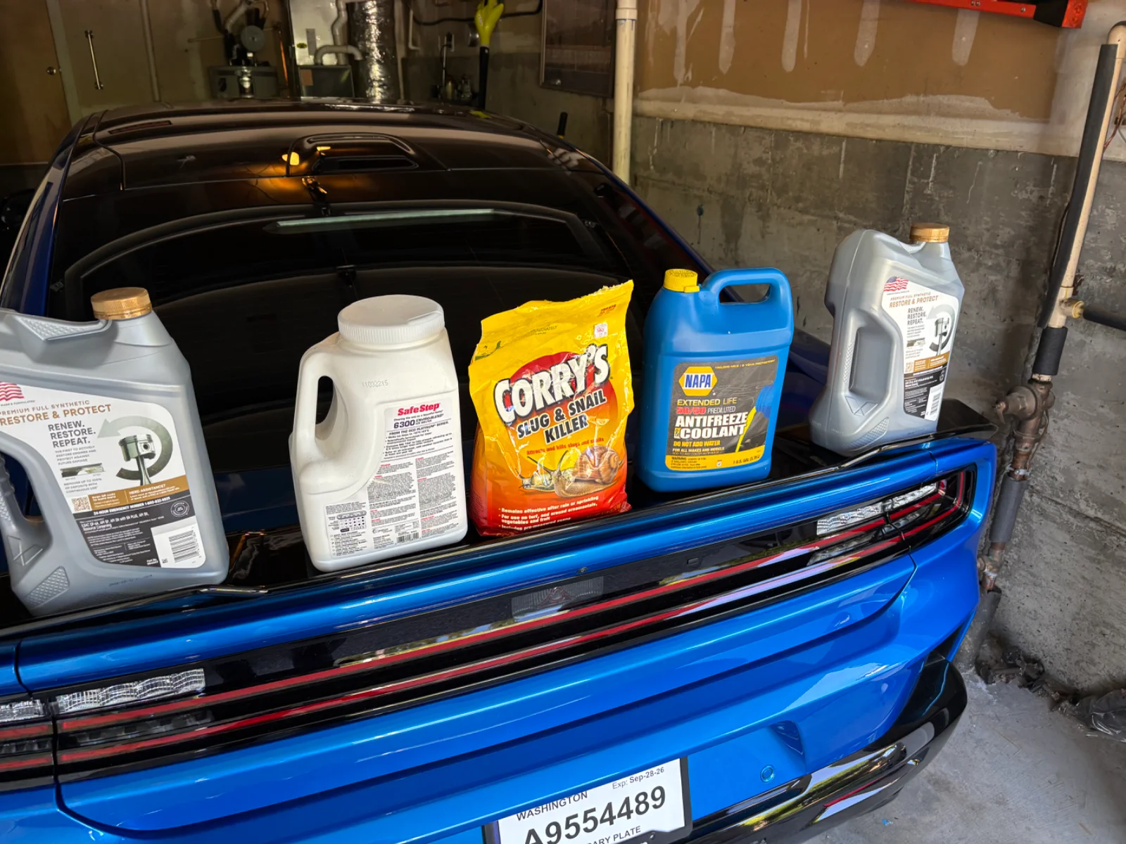

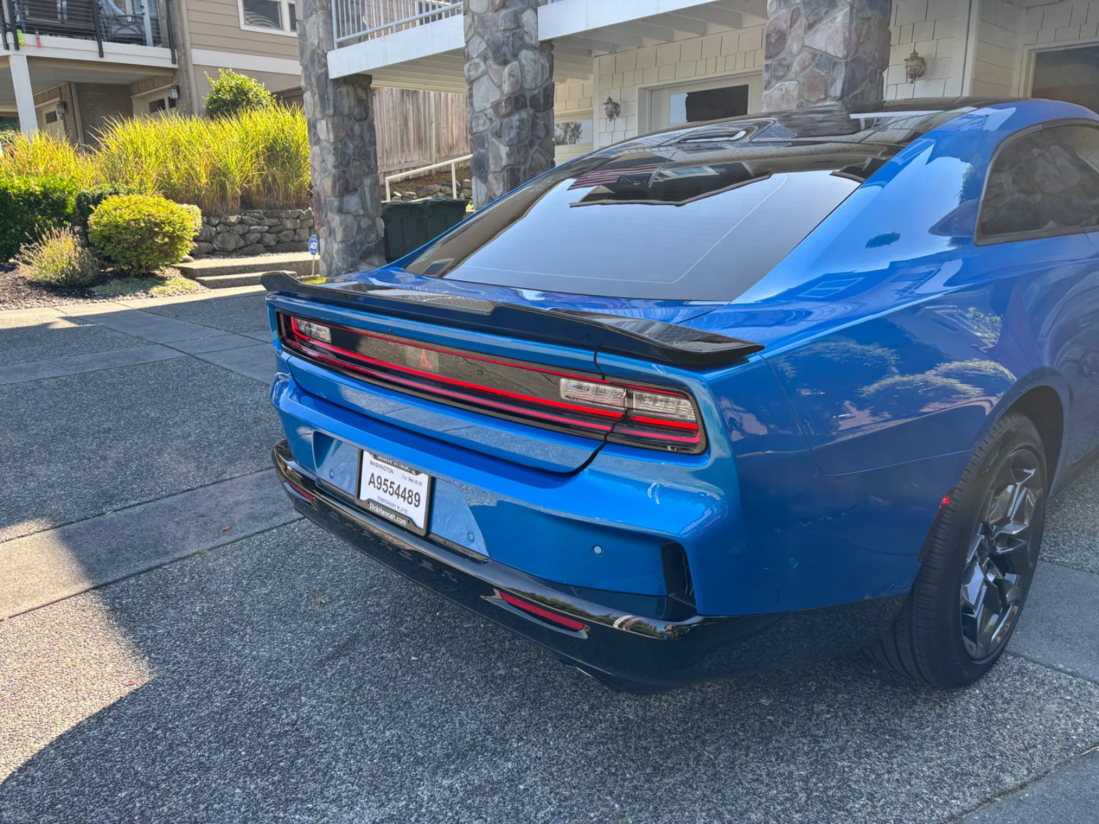

Installed! I added 2 more rows of 3M tape between the 3 they have, wiped on the adhesive activator and will keep pressure on overnight. Definitely want 24 hrs cure before freeway or car washes etc.

Was there a set of instruction? The video I watch had round tape to plug holes. Are these items inside the foam wrapper? Good idea to weight down. Looking good. Later RJD
No instructions, just a little baggie with 2 wipes of the activator and an extra tube.
There are 2 small holes under for possible screws, but no hardware or anything.
When I did one on my 300, it had all the hardware and tape. That was a PITA to align, mark and drill. That one said the screws weren’t required, but I preferred to use.
I think if you live in a 100+ summer or below freezing winters area, more than the 3M tape would be preferable. This one doesn’t stick up too much to get wind pressure, so we will see

Thanks for the info. The video I watched showed they provided round tape plugs to cover the screw holes. When mine gets installed will be using a type of epoxy to hold it down. Later RJD
