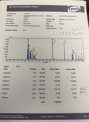

Since I am a chemist, and I have my trusty Agilent 7890B Gas Chromotograph at work, I took samples of the fuel I bought this morning, found one of the few E85 stations in Wakefield MA, bout 30 min from my house.. The E85 pump is labeled as 51-83% Ethanol ....
The results came in at 55. 3% ethanol for the E85 and 7.7% for the 93 Unleaded. That gives me E21 booo I would have needed almost 8 gallons to hit the target, but don't count on the same results.

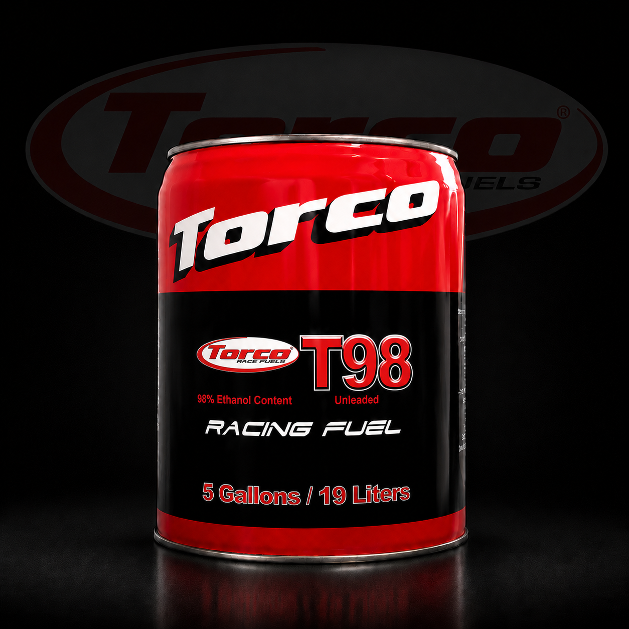

Torco T98 98% Blend Ethanol Race Fuel
Torco T98 Race Ethanol is a consistent 98% blend for maximum boost and cooling. Outperforms E85 with higher oxygen content. Available in 5-gallon pails Shop now
There is a VP fuel store in Lowell not too far and they stock VP X98 essentially the same 98% Ethanol 2% gasoline blend
