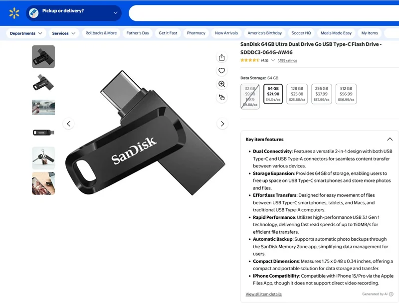

I've used flash drives that were readily available, which ended up being Sandisk from Walmart.
USB TYPE A/3.0 for the Durango 392, and USB Type C for the Charger:
I got the Dual Drive Sandisk 64 GB Type 3.0/Type C for $22, which has the convenience of both Type A/3.0 on one end, and USB-C on the other.
The 64 GB has the smallest storage space, as you don't need much for music:
