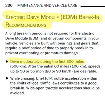

Owners manual states 300 miles (500 km).
This applies for both EV and ICE Chargers.

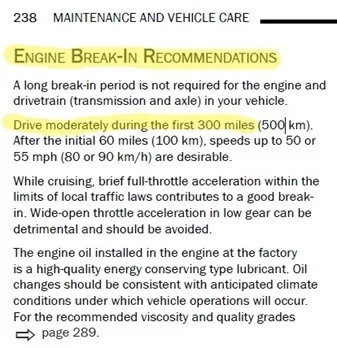

I'm just going by what it states in the owners manual as per the manufacturer's instructions, the one's who are actually warrantying the vehicle:
"Drive moderately during the first 300 miles (500 km)."
"A long break-in period is not required for the engine and drivetrain (transmission and axle) in your vehicle."
When I bought the car, a service advisor suggested a 500 mile break-in. But I think he was confusing "miles" with "kilometers" as indicated in the manual.
So 300 miles is what the owners manual advises. Good enough for me!

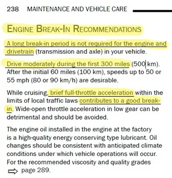

Every automobile forum I've ever been on has this exact dialogue going on about "vehicle break-in".
No exceptions. Every single one of them. And the answers people offer are always the same.
I've always responded with one remark because there are no other logical conclusions.
The manufacturer is the one who foots the bill when things break under warranty.
They've made themselves responsible through the guidelines they've written.
So follow their official recommendations.
These are the manufacturers official recommendations:
  1. Long break-in's are NOT required
  2. Drive moderately for the first 300 miles
  3. Short full throttle bursts are okay during that period
That's it. Their engineers/lawyers thought to include nothing else.
