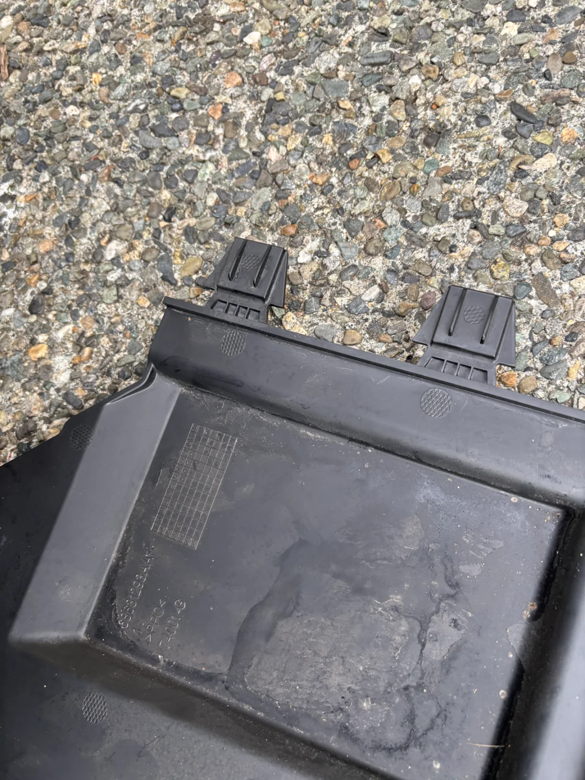

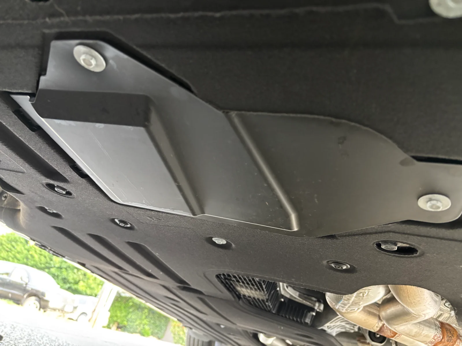

First, the access is much farther back with a little door (no need to remove the whole covers). The door is hinged and took a little finagling to get out- probably the longest part since wasn’t forcing it.

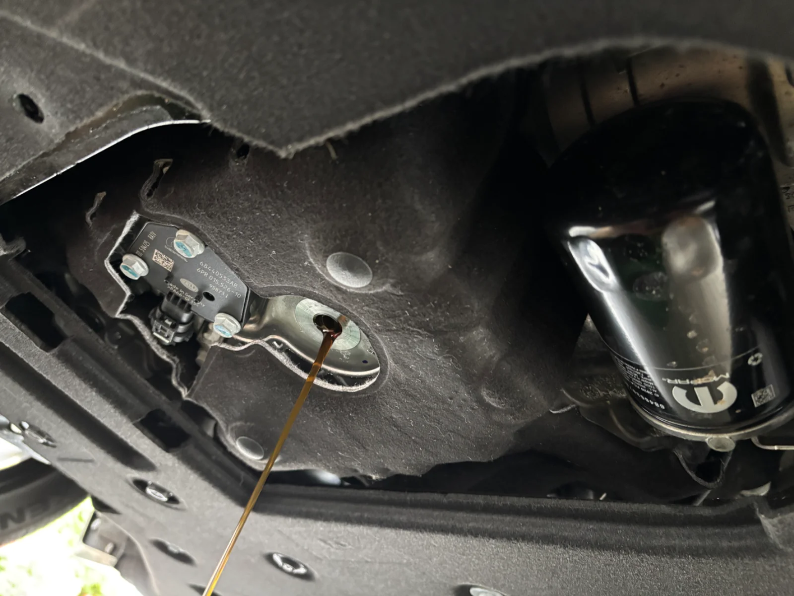

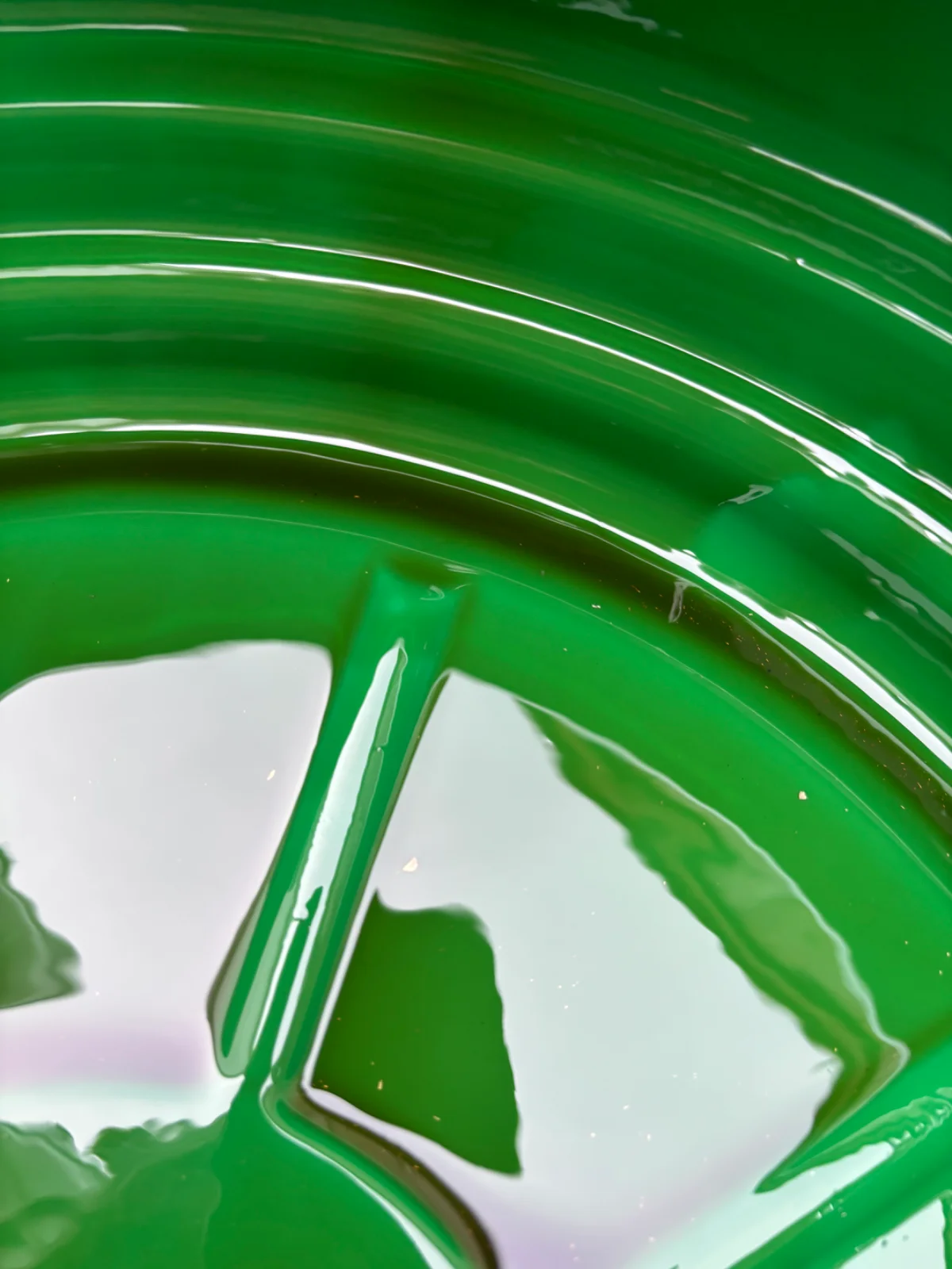

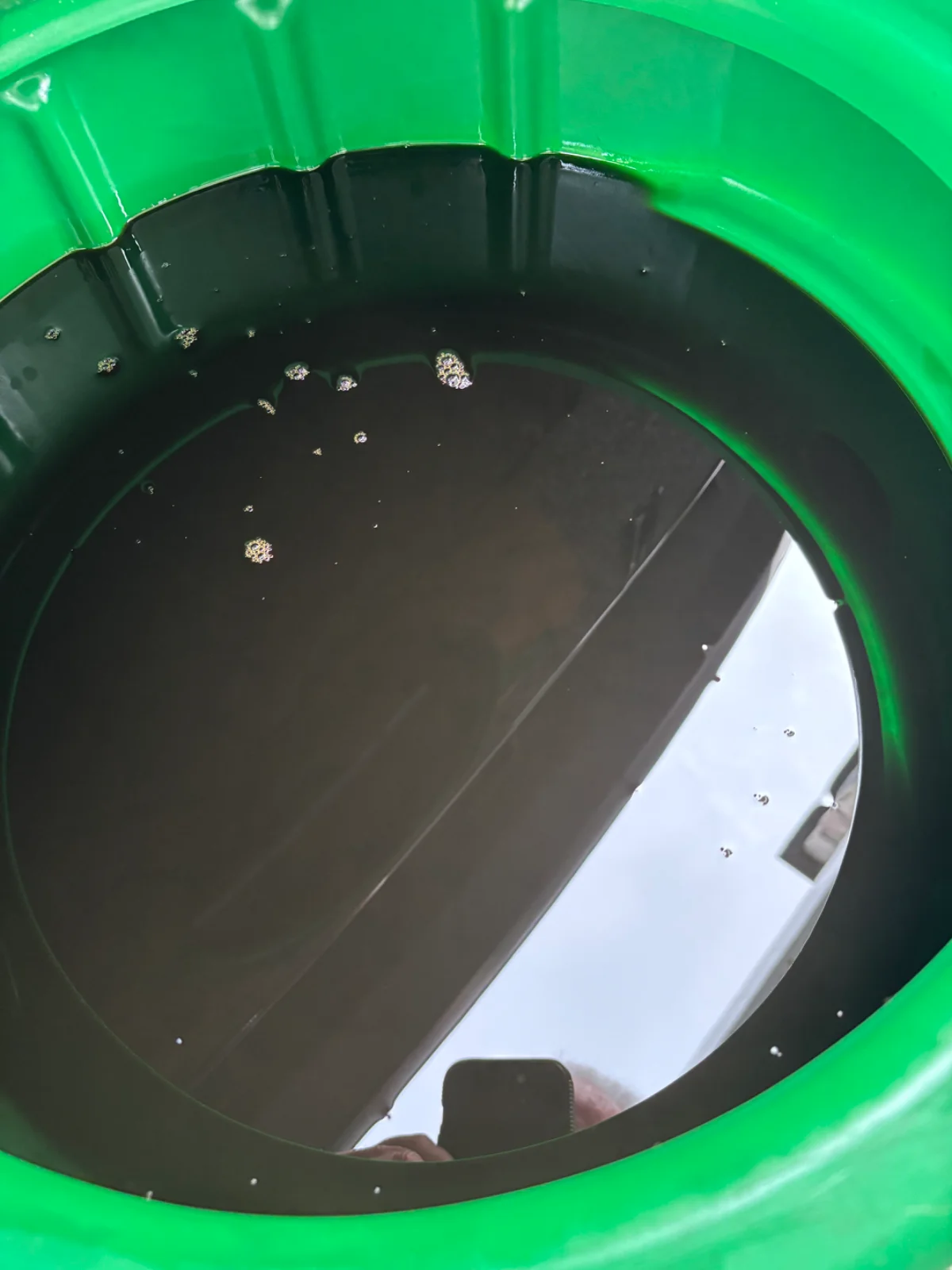

Drain is straight down- no surprise missing the pan! The filter is horizontal and a little tighter than previous gen to get off. I did not swap filter since only 500 miles and the factory uses a gorilla to put these on. I have always used K&N filters with a 1” nut on bottom, which makes removal super easy. Limited space here, so plan accordingly- see photos.

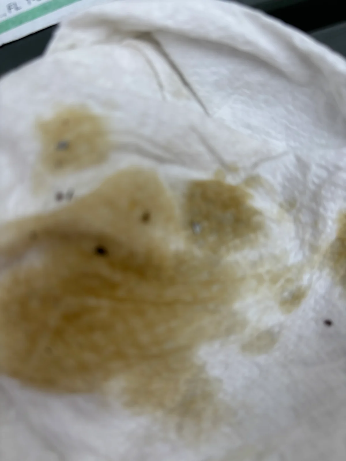

Of note is plenty of sparkly stuff and some sizable pieces on oil from break in- see photos. Also definitely dark- so I would NOT run this to 10k or anything. I plan to do again at about 3k miles with filter. This drain is going to Blackstone along with subsequent for analysis and proof for warranty that I did timely changes 😉
Motor Oil Geek and others recommend multiple changes in first 10k miles. I used 5W-20 Restore & Protect and plan to continue with that.

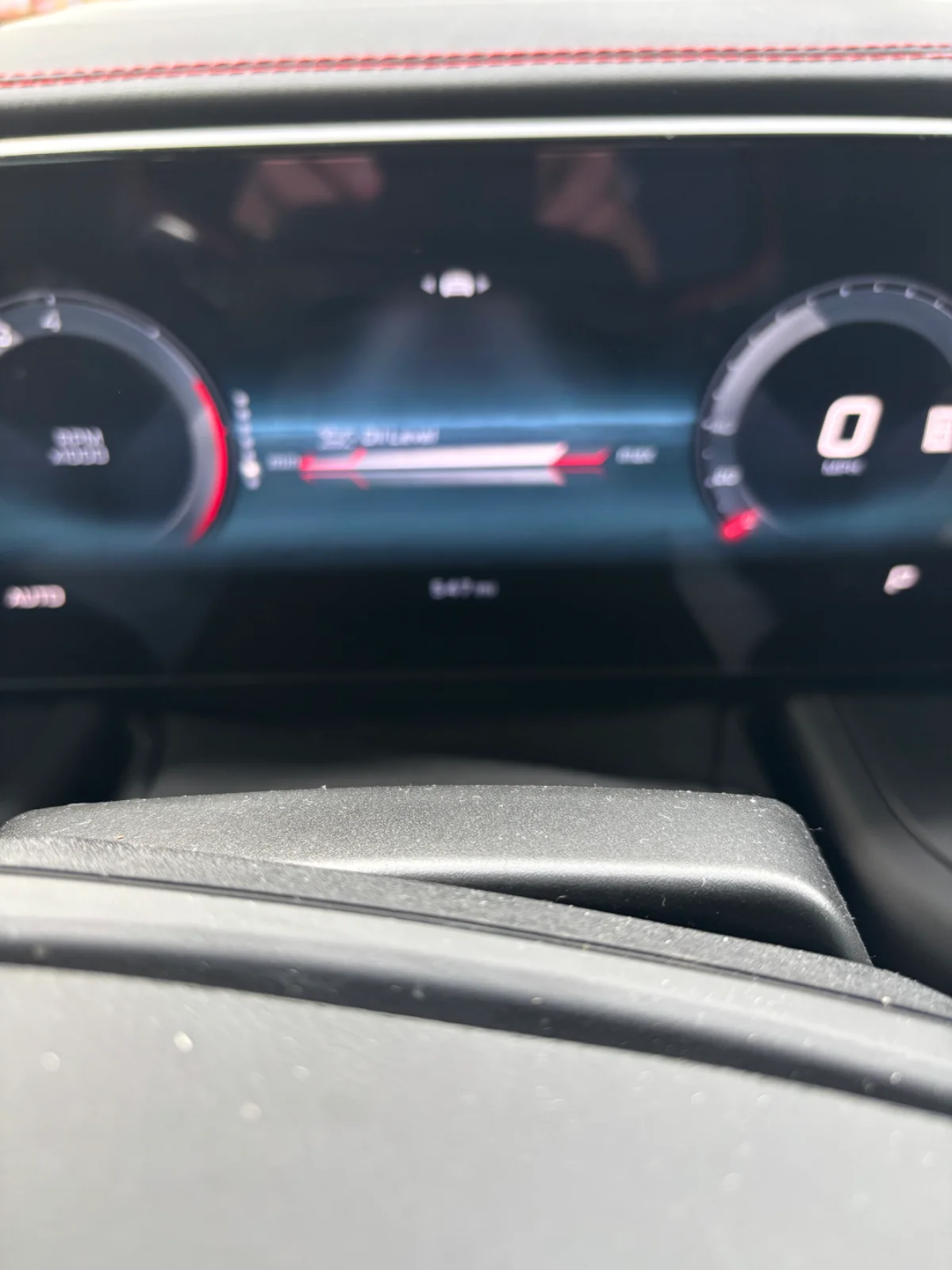

Also- there is an oil level reset procedure, but given a little time and oil temp on flat ground, it resets automatically. Initially when I restarted the engine a “Max Oil Level Exceeded”’message came up, but that went away in about a minute and it is setting at just touching MAX with 7 qts in leaving old filter. I guessed the filter probably had 1/2 qt and fill capacity is 7.5 qts- so next time with filter change, I’ll just put 7 again and see where it sets. Factory fill on mine and others seems to be about 3/4 to max.

I had read somewhere that the oil level reset requires an interval of drainage before refilling. I’ll try to find it, there’s no crush washer or one use drain plug it seems
Oil Level Display - How To Refresh
The oil level is automatically monitored when the vehicle is parked on a level surface, the oil is warm and the engine has been off approximatly four minutes. To refresh the oil level display (after a quart of the correct oil has been added), follow this process:
● Run the engine until the oil temperature is above 180°F (82°C).
● Park the vehicle on relatively level ground.
● Turn the engine off and cycle the Start button to the ON/RUN position. Wait four minutes with the engine off, and the button in the ON/RUN position.
● Start the engine and the new oil level will be available in the Vehicle Info menu (accessible via the navigation buttons on the steering wheel).

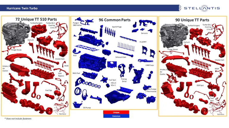

The HO is speced for 0-40 and the SO for 0-20. Most manufacturers spec 20W for less friction/more mpg. Attached is the Stellantis diagram of parts shared and unique with the engine block the most obvious shared component. HO has forged crank, rods and pistons but the SO has a higher compression ratio (9.5 vs 10.4). So 40w shouldn’t actually matter in the RT version if the engineers call for it in the Scat - probably for its bigger turbos and presumed more performance use. This isn’t like a 5.7 vs 6.1 or 6.4 that had oil spec differences when the concern then was thicker oil on the MDS lifter operation (even the 6.4 with MDS was spec 0w-40)
