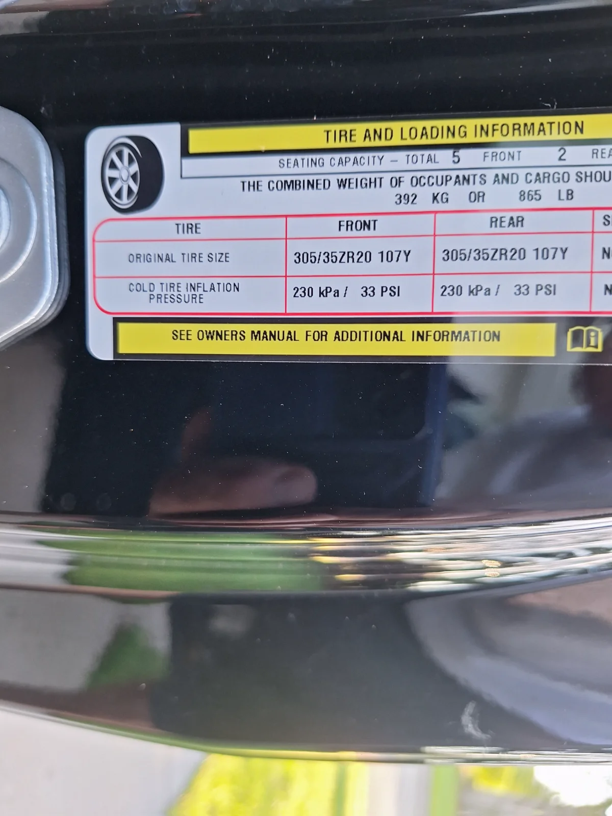

Where did you read this? Come
one people, PLEASE read the manual.
AI said they were the same. However, please feel free to share a shot of the placard so the rest of us can learn along with myself...... Along with your working phone app?
Ok correct, door jam says 33 tire says max 50 psi working phone app not going to show you anything that's already been discussed. Later RJD

Sure the door jam sticker did not say 33 as mine did? later RJD

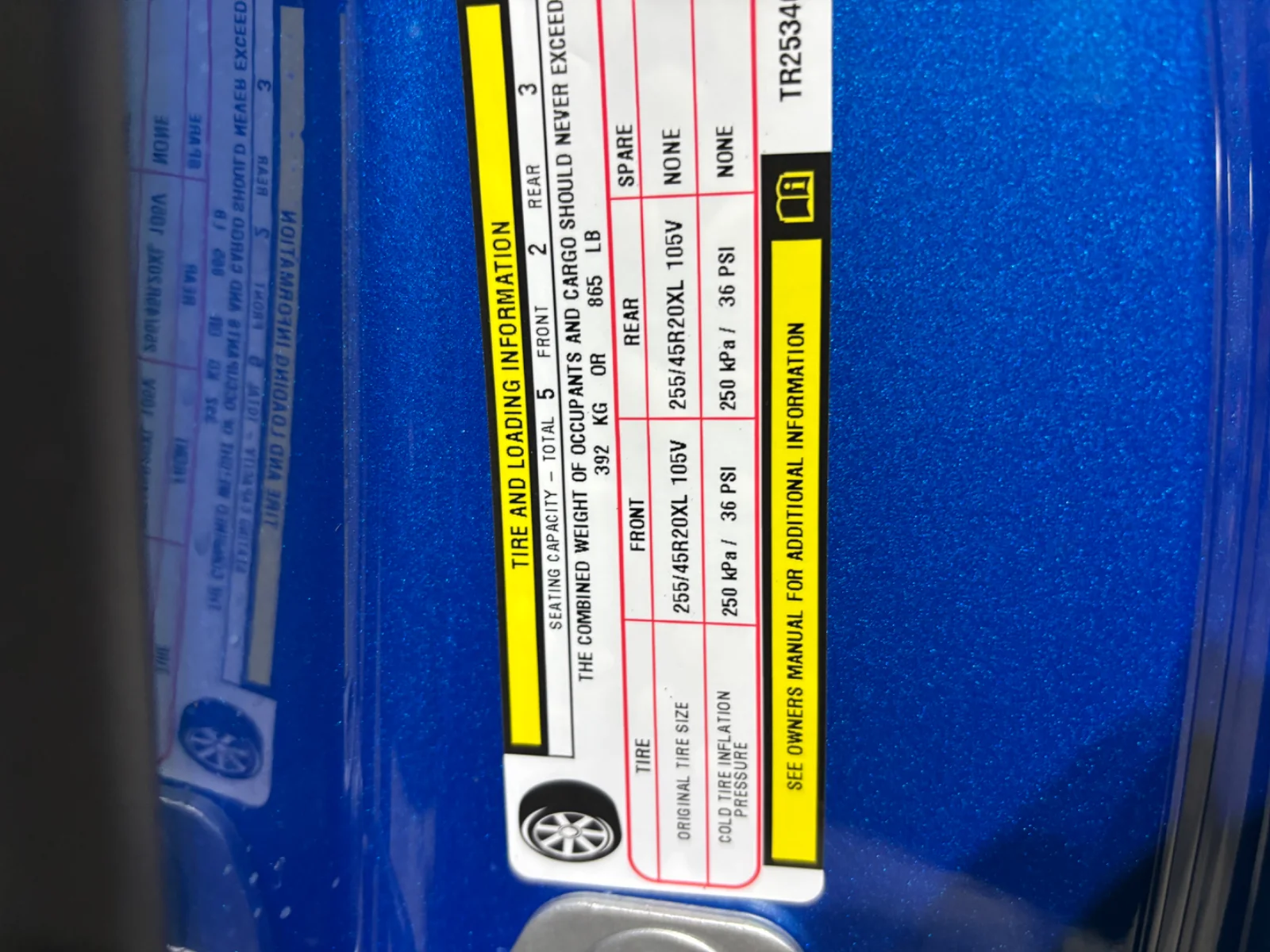

I have the 255/45 tires. Placard calls for 36psi. Makes sense, it’s high school physics guys. Smaller contact patch, same weight, needs higher pressure to support same weight.
