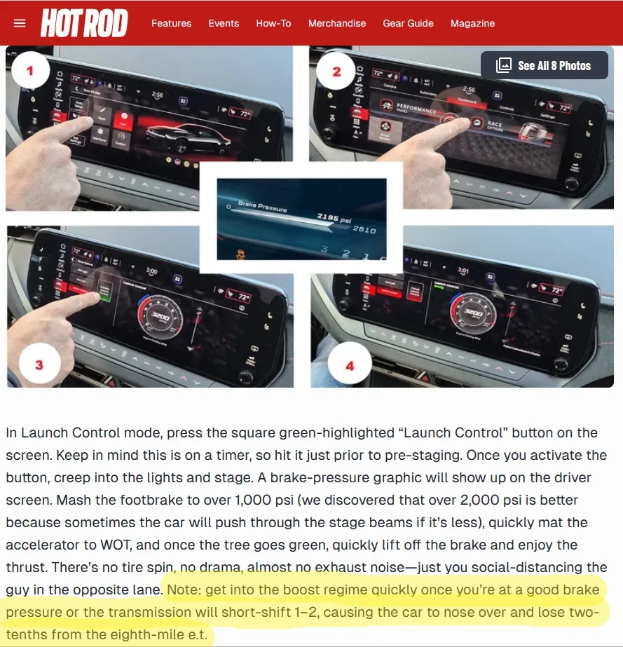

When Hot Rod magazine drag tested the car they also encountered nose dive. They explained it this way and said how to avoid it:
What does this even mean 😂? “Get into the boost regime quickly”…
I would also like to know what they're trying to say. At first I thought it meant don't hold it revved for too long but the bit about good brake pressure makes it sound like you need to start revving quicker? Is that image auto-translated from another language or AI slop or something?
Edit: I have a theory: they are instructing how to do this at a drag strip with limited time before green so I think they are actually saying make sure you start revving quickly so you can build up more boost before launching? I remember when RacerX was testing he was launching pretty quickly. Maybe you gotta let it cook?

I don't have a Sixpack (I have the Daytona), but my assumption is "Nail the throttle" while mashing the brake pedal, don't "roll it on".
