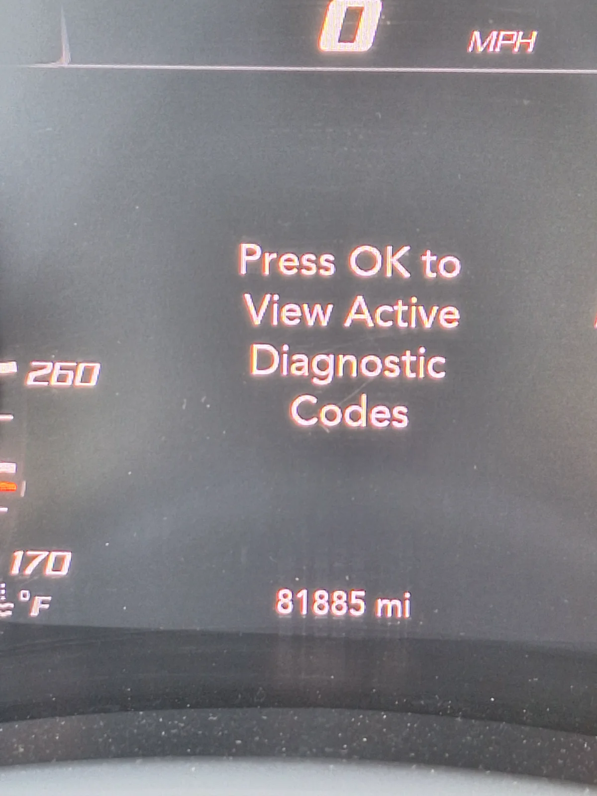

Can you pull up the codes in the center dash and reset them like the current Chargers?
I wasn't able to find a way to do this on my '15 charger. I also tried to find a a way to do this on my Sixpack but had no luck. I bought the cheapest code scanner on Amazon and it works to read and reset the codes.
20260213_144438.webp I thought that I can reset them when in Park or something also.
