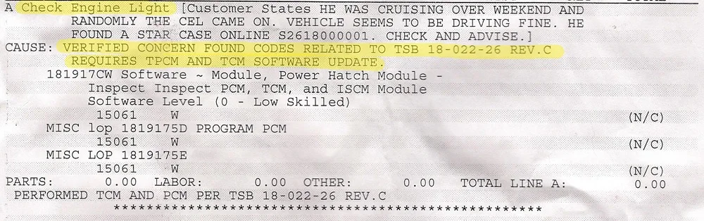

Check engine light came on yesterday!
Got my car 2 weeks ago, has less than 1,000 miles.
Brought it into Service Dept. this morning, 2 hours later all set.
TPCM and TCM software updates applied, check engine light gone.

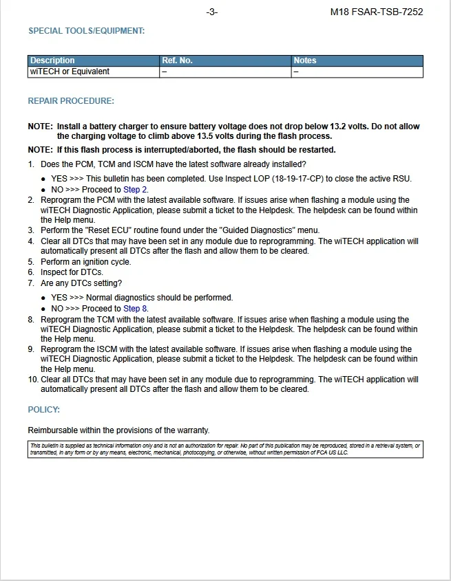

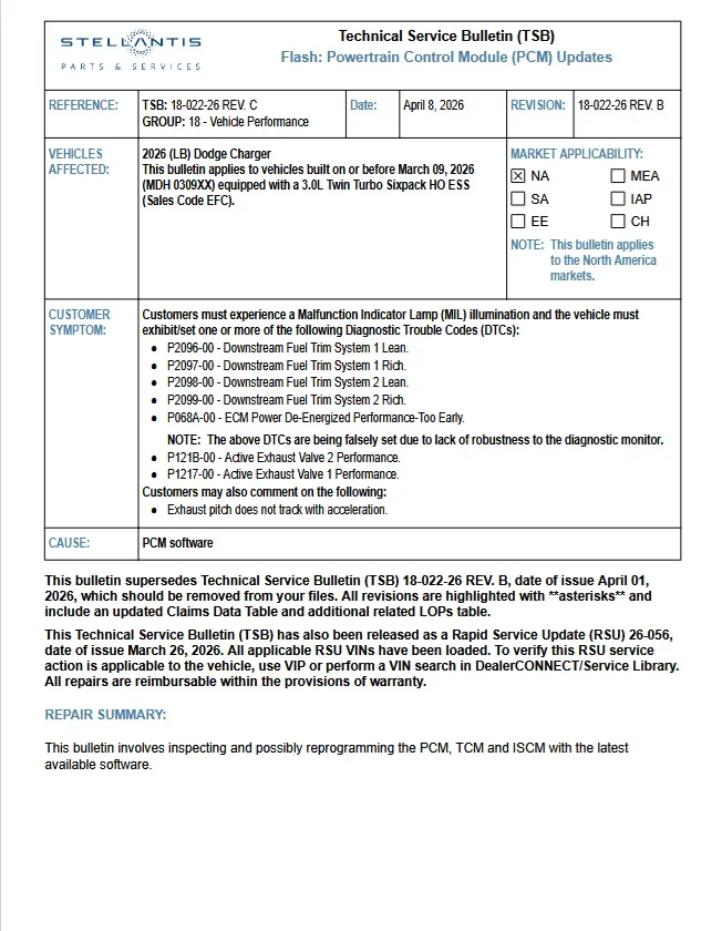

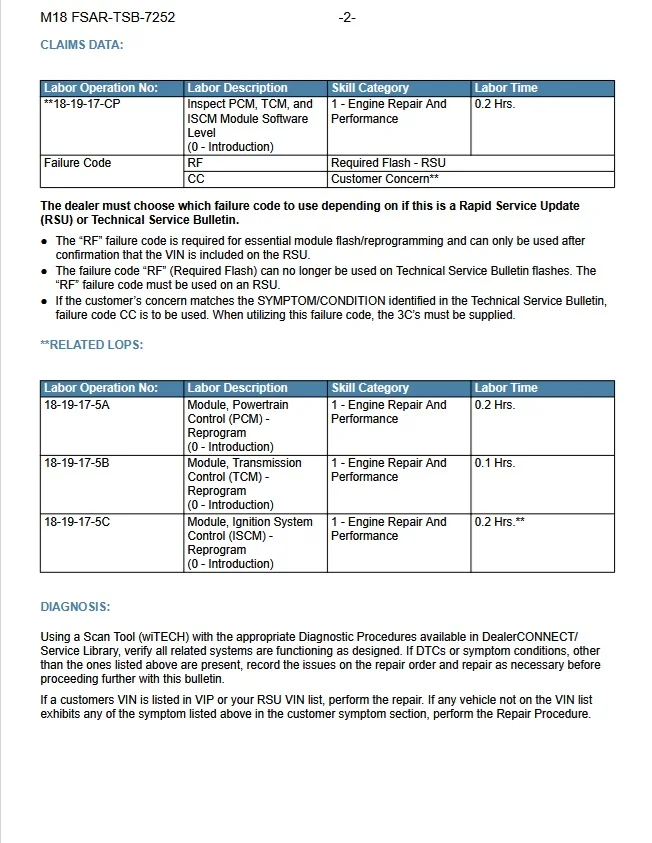

Here's the TSB:
TSB 18-022-26 REV. C
Here's the link to the pdf:
https://static.nhtsa.gov/odi/tsbs/2026/MC-11031325-0001.pdf
Here's the TSB:

The TSB claims it's for earlier models.
But the dealer tech conversed with STAR before doing the update.

I had those fuel trim codes, too, but then something much worse happened: I parked in the paid garage downtown, shifted it to park, maybe shut it off, but then all the PRND lights flashed on and off at once, a message saying "Service Shifter System" popped up, and it freaking locked the shifter! Found codes U1465 and U1466 with my OBD tool but they could not be reset. Panic! I'm in a paid garage, stuck in park, in a car that has no manual release out of park, with an immobilized car. I would've had to get a flatbed with dollies into the unattended garage to tow it to a dealer.
LUCKILY...I went back after 20 minutes or so, turned it on, and it shifted fine, as if nothing had happened. I got it to the dealer right away. They applied this TSB: 18-022-26 REV. D for the fuel trims and ESM (shifter) software from 68590558AF to 68590558AG, and all the problems are gone and no MIL.
