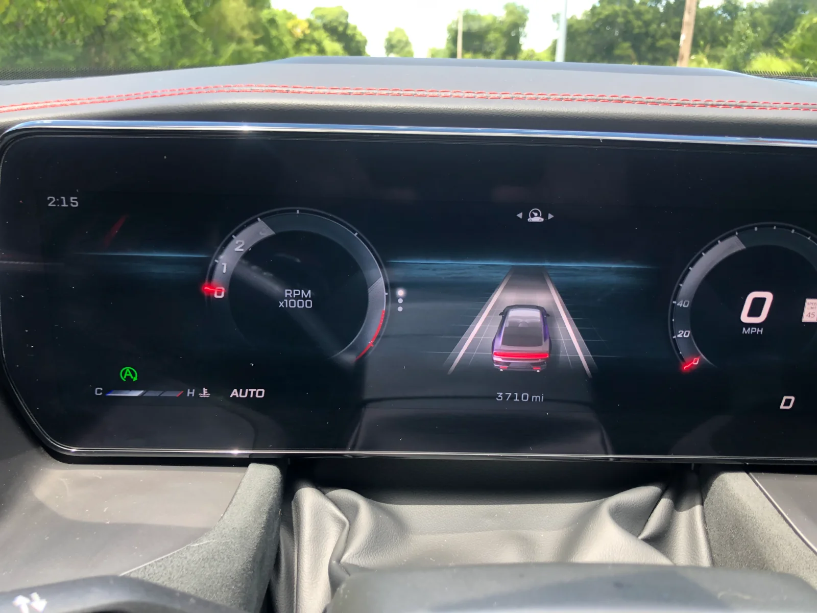

I played today and came to an easy stop with just a little brake pressure. Pushed a little harder and engine stopped. Tach also went to zero (see photo) and little green light in lower left of photo lit up
I eased up the pressure on the brake but not enough to allow car to move and the engine started back up.
